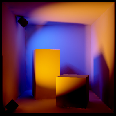

Outputted from pov as 48 bit linear. Compressed in Photoshop
using transfer curve (intensity only) based on a film response
curve from Kodak site. It's a typical compression curve. Then
gamma 2.2 corrected and converted to 24 bit.
My tests with the Cornell box indicated that correct fade_distance
for diffuse sources is same as source diameter. The spotlights
use (90^2/falloff^2)*diameter as fade distance because of the
directional nature of the source. I'm not sure if this is correct
but it looks ok. Any lighting engineers here?

From: Tony[B]
Subject: Re: Photographic compression (50k)
Date: 9 Aug 2001 23:54:29
Message: <3b735af5@news.povray.org>
That looks very nice. You'll have to write a tutorial for this. :)

From: Kari Kivisalo
Date: 10 Aug 2001 05:38:27
Message: <3B73AC3A.ED9604C@pp.htv.fi>
ingo wrote:
>  If the above is not terebly wrong, it seems to me that what you are
> doing is adjusting the contrast range of the mid tones only, as there
> is no information about the higjlights in the file.
All the data is non clipped. By scaling light source and ambient
source intensities I can make sure the scene fits in 0-1 range.
A scene developed normally in povray where sun shines into a room
without light sources the lit area might have 500% intensity and
get clipped when the rest of the room seems to be lit enough. I then
scale all sources by 0.2 so I get all the data. That is why 16 bits
per channel are needed.
> Now we over expose to make shure that we get all the details in
> the shadow. If we develop this film normaly, the resulting negative is
> not usable, it has a too high density and contrast to print. So we
> develop shorter.
> In a
> low-contrast scene the opposite is done, under-expose, over-develop.
out ^          __
    |      _--*
    |    _/
    +------------> in
So developing stretches the scene's intensity range down along the
curve. Exposing stretches the range up along the curve. I just looked
at linearised film response curve and concluded that it's just a typical
compress operation. Check: density=blackness ? :)
_____________
Kari Kivisalo

From: Mael
Date: 10 Aug 2001 09:28:03
Message: <3b73e163$1@news.povray.org>
Very nice.. Can we see the non post-processed image to see the effect of
compression ?
M
From: Kari Kivisalo
Date: 10 Aug 2001 10:21:30
Message: <3B73EE91.7FB6B38@pp.htv.fi>
> compression ?
http://www.pp.htv.fi/kkivisal/48bit.jpg
http://www.pp.htv.fi/kkivisal/48bit2.jpg
_____________
Kari Kivisalo
From: Tony[B]
Date: 10 Aug 2001 11:16:40
Message: <3b73fad8@news.povray.org>
You've got to be kidding! Wow!
