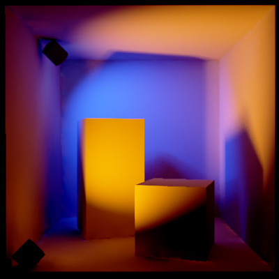

Outputted from pov as 48 bit linear. Compressed in Photoshop
using transfer curve (intensity only) based on a film response
curve from Kodak site. It's a typical compression curve. Then
gamma 2.2 corrected and converted to 24 bit.
My tests with the Cornell box indicated that correct fade_distance
for diffuse sources is same as source diameter. The spotlights
use (90^2/falloff^2)*diameter as fade distance because of the
directional nature of the source. I'm not sure if this is correct
but it looks ok. Any lighting engineers here?
_____________
Kari Kivisalo
Download 'film_48bit.jpg' (47 KB)
Preview of image 'film_48bit.jpg'
From: Tony[B]
Subject: Re: Photographic compression (50k)
Date: 9 Aug 2001 23:54:29
Message: <3b735af5@news.povray.org>
That looks very nice. You'll have to write a tutorial for this. :)

From: Mael
Date: 10 Aug 2001 09:28:03
Message: <3b73e163$1@news.povray.org>
Very nice.. Can we see the non post-processed image to see the effect of
compression ?
M
From: Kari Kivisalo
Date: 10 Aug 2001 10:21:30
Message: <3B73EE91.7FB6B38@pp.htv.fi>
> compression ?
http://www.pp.htv.fi/kkivisal/48bit.jpg
http://www.pp.htv.fi/kkivisal/48bit2.jpg

From: Tony[B]
Date: 10 Aug 2001 11:16:40
Message: <3b73fad8@news.povray.org>
You've got to be kidding! Wow!

From: Tek
Date: 10 Aug 2001 19:14:52
Message: <3b746aec@news.povray.org>
That looks so real! Great technique, I'll have to try it. :)
Tek
