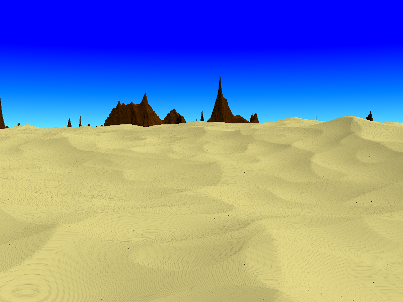

Another question deals with the image attached here: how to do realistic
dunes? The large-scale structures of my dunes are already quite
satisfying (I used the "turbulence" function in Heightfield Lab to
generate the heightfield) - but how can I do the small ripples covering
the windward sides of the dunes? Obviously, neither ripples nor wave
normals do the trick...
How about a marble normal? Have you tried that?
