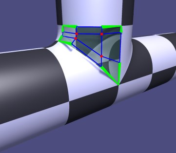

Here's the image illustrating my problem from povray.general.  In case
you didn't see that one, I'm looking for a macro that eliminates the
need to enter the red points manually in the bezier patch.  Thanks.
 - Rico

Why don't you just use a blob with two cylinder components?

I tried many things such as blobs, cylinders, and meshes, but the joints
got very ugly with blobs where there were three or four intersecting
cylinders all starting from slightly different places.  If you look by the
pedals on a bike, there are about five tubes that all affect each other but
start from different spots.  There are also a couple of bent tubes on a
bike such as the fork and the spot in the back where the down tubes
diverge.  Those aren't possible with blobs.
 - Rico

I wouldn't say that, bent tubes could be easily done with a lot of
spherical components.  Also several cylinders joining in one point are no
problem, but it would be quite difficult to do this with patches.
Attached it the following:
blob
  threshold 0.5
  cylinder { -z, z, 0.3, 1 }
  cylinder { x*0.3, x, 0.3, 1 }
  sturm
Using megapov's isosurface/isoblob object could be even more flexible, but
also more difficult to handle.
Download 'blobtest_01.jpg' (5 KB)
Preview of image 'blobtest_01.jpg'

Try looking at:
http://www.trekbikes.com/bikes/2001/road/5200_main.html
This is the bike that I am trying to make.  I personally find bezier patches to
be much more efficient and precise than blobs, and I also wanted to be able to
make non-elliptical tubes and use uv-mapping.  For these reasons, I personally
think that patches would make much more sense if there was a way around those
middle points.
 - Rico

Reusser wrote:
> Try looking at:
more efficient - maybe
more precise - no way, bezier patches are internally converted to meshes
so they have a limited accuracy, while blobs are not (and most problems
with artefacts can be solved by adding 'sturm')
> middle points.
To do this you will have to describe the transit mathematically, probably
in form of a blob-like model - it would not look much different then in
the end.

It looks like, for your application, you can just do simple addition.
If the corner is point "A" and the two adjacent edge points are "B" and
"C", then it would seem that the interior point adjacent to "B" and "C"
would be approximated by B+C-A.

By precise, I meant the control over the appearance, not necessarily the
mathematical precision.  Isn't there an accuracy setting anyway?  For me, the main
problem with blobs is that the transitions between the joints are too abrupt.  You
can see this in your example.  I was hoping to recreate the smooth, flowing look of
the frame.
 - Rico

Thanks!  I can't believe I didn't see that!  I was just thinking too hard, or not
hard enough.  :-)
 - Rico
> the frame.
Then maybe try an isosurface, like explained here (bottom of the page):
http://webpages.charter.net/omniverse/stb_iso/iso_tutorial3.html
