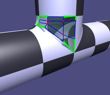

Here's the image illustrating my problem from povray.general.  In case
you didn't see that one, I'm looking for a macro that eliminates the
need to enter the red points manually in the bezier patch.  Thanks.
 - Rico

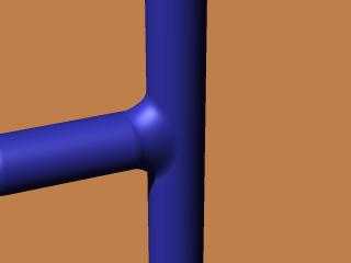

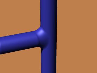

blob
  threshold 0.5
  cylinder { -z, z, 0.3, 1 }
  cylinder { x*0.3, x, 0.3, 1 }
  sturm
Using megapov's isosurface/isoblob object could be even more flexible, but
also more difficult to handle.
Download 'blobtest_01.jpg' (5 KB)
Preview of image 'blobtest_01.jpg'

From: Ron Parker
Subject: Re: bezier patch problem
Date: 25 Jun 2001 12:15:19
Message: <slrn9jeoso.2b8.ron.parker@fwi.com>
It looks like, for your application, you can just do simple addition.
If the corner is point "A" and the two adjacent edge points are "B" and
"C", then it would seem that the interior point adjacent to "B" and "C"
would be approximated by B+C-A.

From: Reusser
Date: 25 Jun 2001 12:37:56
Message: <3B3767D5.F935BFE1@chorus.net>
Christoph Hormann wrote:
> more efficient - maybe
> more precise - no way, bezier patches are internally converted to meshes
> so they have a limited accuracy, while blobs are not (and most problems
> with artefacts can be solved by adding 'sturm')
By precise, I meant the control over the appearance, not necessarily the
mathematical precision.  Isn't there an accuracy setting anyway?  For me, the main
problem with blobs is that the transitions between the joints are too abrupt.  You
can see this in your example.  I was hoping to recreate the smooth, flowing look of
the frame.
 - Rico
From: Reusser
Date: 25 Jun 2001 12:42:32
Message: <3B3768EA.C39D4917@chorus.net>
Thanks!  I can't believe I didn't see that!  I was just thinking too hard, or not
hard enough.  :-)
 - Rico
