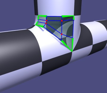

Here's the image illustrating my problem from povray.general.  In case
you didn't see that one, I'm looking for a macro that eliminates the
need to enter the red points manually in the bezier patch.  Thanks.
 - Rico
Download 'bp2.jpg' (14 KB)

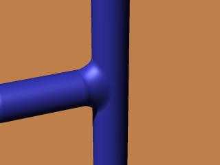

Why don't you just use a blob with two cylinder components?

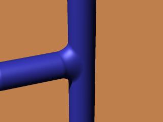

I wouldn't say that, bent tubes could be easily done with a lot of
spherical components.  Also several cylinders joining in one point are no
problem, but it would be quite difficult to do this with patches.
Attached it the following:
blob
  threshold 0.5
  cylinder { -z, z, 0.3, 1 }
  cylinder { x*0.3, x, 0.3, 1 }
  sturm
Using megapov's isosurface/isoblob object could be even more flexible, but
also more difficult to handle.
Download 'blobtest_01.jpg' (5 KB)
Preview of image 'blobtest_01.jpg'

more efficient - maybe
more precise - no way, bezier patches are internally converted to meshes
so they have a limited accuracy, while blobs are not (and most problems
with artefacts can be solved by adding 'sturm')
> For these reasons, I personally
> think that patches would make much more sense if there was a way around those
> middle points.
To do this you will have to describe the transit mathematically, probably
in form of a blob-like model - it would not look much different then in
the end.
From: Ron Parker
Subject: Re: bezier patch problem
Date: 25 Jun 2001 12:15:19
Message: <slrn9jeoso.2b8.ron.parker@fwi.com>
It looks like, for your application, you can just do simple addition.
If the corner is point "A" and the two adjacent edge points are "B" and
"C", then it would seem that the interior point adjacent to "B" and "C"
would be approximated by B+C-A.
By precise, I meant the control over the appearance, not necessarily the
mathematical precision.  Isn't there an accuracy setting anyway?  For me, the main
problem with blobs is that the transitions between the joints are too abrupt.  You
can see this in your example.  I was hoping to recreate the smooth, flowing look of
the frame.
 - Rico
Thanks!  I can't believe I didn't see that!  I was just thinking too hard, or not
hard enough.  :-)
 - Rico
> the frame.
Then maybe try an isosurface, like explained here (bottom of the page):
http://webpages.charter.net/omniverse/stb_iso/iso_tutorial3.html
