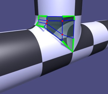

Here's the image illustrating my problem from povray.general.  In case
you didn't see that one, I'm looking for a macro that eliminates the
need to enter the red points manually in the bezier patch.  Thanks.
 - Rico
Download 'bp2.jpg' (14 KB)

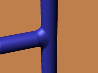

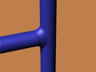

blob
  threshold 0.5
  cylinder { -z, z, 0.3, 1 }
  cylinder { x*0.3, x, 0.3, 1 }
  sturm
Using megapov's isosurface/isoblob object could be even more flexible, but
also more difficult to handle.
Download 'blobtest_01.jpg' (5 KB)
Preview of image 'blobtest_01.jpg'

Reusser wrote:
> Try looking at:
> http://www.trekbikes.com/bikes/2001/road/5200_main.html
> This is the bike that I am trying to make.  I personally find bezier patches to
> be much more efficient and precise than blobs, and I also wanted to be able to
> make non-elliptical tubes and use uv-mapping.
more efficient - maybe
more precise - no way, bezier patches are internally converted to meshes
so they have a limited accuracy, while blobs are not (and most problems
with artefacts can be solved by adding 'sturm')
> For these reasons, I personally
> think that patches would make much more sense if there was a way around those
> middle points.
To do this you will have to describe the transit mathematically, probably
in form of a blob-like model - it would not look much different then in
the end.
It looks like, for your application, you can just do simple addition.
If the corner is point "A" and the two adjacent edge points are "B" and
"C", then it would seem that the interior point adjacent to "B" and "C"
would be approximated by B+C-A.
Thanks!  I can't believe I didn't see that!  I was just thinking too hard, or not
hard enough.  :-)
 - Rico
