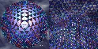

Not finished yet, I think it has potential.  Anyone want my spaghetti
code?
Dan Johnson
http://www.geocities.com/zapob
Download 'geodesic.jpg' (124 KB)

The basic function takes three points two define a spherical triangle.
Then it divides each of the sides evenly by a number you specify, and
stores them in a two dimensional array.
x
x-x
x-x-x
x-x-x-x
x-x-x-x-x
The x's are points in the array, and the lines represent how a function
might access the array to find the points of a triangle or edges.  I use
lots of little functions.  One to find points, one to store them in an
array, one to find edges.  I only generate 1/20 of the sphere, and then
rotate it to complete the job.  It also builds an octahedron -
tetrahedron spaceframe onto the group of triangles.  My translation
functions should be able to handle struts other than cylinders
appropriately, so I am trying to think about what I want to replace them
with.

That looks really good!
I once read the maths behind geodesic domes, but never got round to actually
trying it. I'd definitely like to see your source.

    What I want to be able to get is something that will divide a solid
sphere into triangles (actually pyramids) so that you have each part go down
to a little point in the center of the sphere.

Do you want the face of the pyramid on the surface to be a curve or a
flat face?  What do you want to do with the pyramids after you have
them?  Do you want them to be csg solids, or triangles, or a solid
triangle mesh?  I could probably adapt my code to do what you want if
you could be specific.

    What I really want to do is subdivide an isosurface made with a map of
the Earth so that I can explode it along the geodesics then re-assemble it.
I can do it with a dodecahedron (12 parts?) but I want to do it in much
smaller sections and I don't know how (whimper).
    I would appreciate any help but please don't go too far out of your way.

I was going to try, and do that, but the code is being stubborn.  It is
not working in so many strange ways that I have no clue how to debug.  I
am on code writing strike, until I am sane again.  I just uploaded my
code to p.b.s-f.  Hope it helps...
