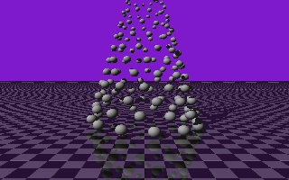

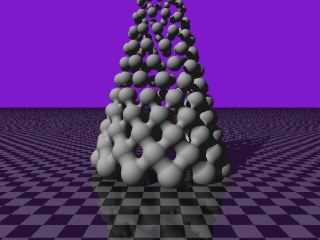

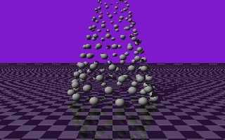

Here is the source - I want something like a lattice here, with all the
'joints' here connected together.  I am just trying desperately to tweak
the numbers in.

oops, here is the source
plane{y,0 pigment{color rgb .5} finish{reflection .2} normal{checker
.4}}
light_source{<-80,100,-90> color rgb 1}
#declare h=1;
#declare mh=100;
blob{threshold .1
#while (h<mh)
    #declare f=(mh-h)/mh;
    #declare a=sin(h)*5*f;
    #declare b=(h)/5;
    #declare c=cos(h)*5*f;
    sphere{<a,b,c>,f/2,f*20}
    #declare h=h+.5;
#end
    pigment{color rgb 1}
camera{location<0,5,-20> look_at<0,4,0>}
sky_sphere{pigment{color rgb<.5,.1,.8>}}

Hi Bryan.
You need to increase the radii of
your sphere components.
In order for sphere components in a
blob to "connect", they must have so
large radii, that if they were "real"
spheres they would "tuch" each other.

And of course their summed "field
strength" in the "connection region"
must be greater than the threshold
for the blob.

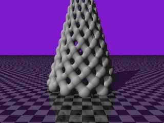

> with all the 'joints' here connected together.  I am just
> trying desperately to tweak the numbers in.
I fiddled with it a bit ...
blob    {
        threshold .4
        #while (h<mh)
        #declare b=(h)/5;
        sphere{<a,b,c>,1.5*f,1}
        #declare h=h+.5;
        #end
        pigment {color rgb 1}
It appears to me that f (multiplied by whatever constant) is the Wrong
Thing for the component radius, unless you want the lattice to break up
at the top.
Anton Sherwood  --  br0### [at] p0b0xcom  --  http://ogre.nu/
Download 'bryan.jpg' (14 KB)
Preview of image 'bryan.jpg'
> is the Wrong Thing for the component radius, unless you want
> the lattice to break up at the top.
But if the radius is constant, the lattice gets thicker at the top.
I see the problem now: the vertical spacing is constant (0.5) but the
horizontal spacing shrinks (in proportion to the diameter of the cone).
Will elliptical components do?:

From: Bryan Valencia
Subject: Re: can't get blobjects to connect
Date: 17 Apr 2001 15:34:42
Message: <3ADC9B5D.B122B156@209software.com>
This is (MUCH) closerto what I want.  Thanks to all who helped.
The effect I am going for is more of an alien "oil rig" (more sinewy, or like
bones) but the concept of the spheres having to touch each other is what I
didnt get.  I was trying to "project" the blob out from the spheres, not
encase the 'energy' in the spheres.  I have been struggling with this concept
for a while now.

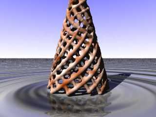

> (more sinewy, or like bones) ...
alien, eh?
#declare h=1;
#declare mh=100;
#declare goldangle = pi*(3-sqrt(5));
blob    {
        threshold .86
        #declare theta = 0;
        #while (h<mh)
        #declare g = sqrt(f);
        #declare zed = 20*(1-g);
        sphere { 0,1.18,1
                translate <5*g,zed,0>
                rotate y*degrees(theta)
        #declare theta = theta + goldangle;
        #declare h=h+.5;
        #end
        pigment { bozo
                color_map {
                        [0 rgb 1]
                        [1 rgb <0.6,0.2,0>]
Download 'bryan2.jpg' (15 KB)
Preview of image 'bryan2.jpg'
