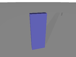

I started a scene for a new radiosity test and I had this strange
result...Where is the problem ? in my scene ? the result is the same
with or without radiosity...
           David
The problem is in:
> // ground
> box {
>   <-500.0, -0.5, -500.0>, <500.0, 0.0, 500.0>
>   pigment {color 0.4}
>   finish {ambient 0.0 diffuse 0.5}
Change 'pigment {color 0.4}' to 'pigment {color rgb 0.4}'
'color 0.4' expands to 'color rgbft 0.4' and thereby you get a partly
transparent floor.  The ghost shape appears on the lower level of the
ground box.
> ground box.
Thanks ! I didn't see it ! too bad...
