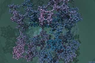

One way of making fractals: you have a region of space where the fractal
will be. You then have rules for making copies of that region
(translate, scale, rotate etc) within itself. Do the same thing within
each of those smaller copies. When you get down to the smallest level
you fill in the tiny copy of the original region. In two dimensions this
can be used to make the classic sierpinsky triangle or fern. I tried it
in three dimensions with an arbitrary set of rules for copying the
region, and placing a blob component whenever the macro got below a box
of width .005 (the original region being from <-1,-1,-1> to <1,1,1>). I
can easily define different rules to get different fractals.
The full-size render (1152x864) has some artifacts, black pixels, in the
blob. What causes that?
32768 blob components, 19880794 bytes, 40m 05s render time.
Comments/criticisms please
Download 'iterated01.jpg' (163 KB)
Preview of image 'iterated01.jpg'

From: Nekar Xenos
Subject: Re: Deterministic method of iterated fractal generation
Date: 16 Mar 2001 03:04:34
Message: <3ab1c912@news.povray.org>
Lovely!
I can't see them here. Does it still show if you push up the maximum trace
level? Unless you're talking about the shadow in the background.
Nekar

this is one of those magic render that the more you look the more you see
if you get the 1152x864 sorted out, post it somewhere as it would make
execellent desktop wallpaper

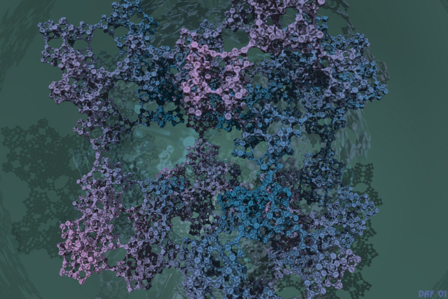

Subject: Artifacts in blob (WAS: Deterministic method of iterated fractal generation)
Date: 16 Mar 2001 16:50:34
Message: <3AB28A11.FF99E2B5@faricy.net>
They don't show up because this has been resized (and cropped). I don't think
it'd be max_trace, since the blob is opaque and nonreflective. Must be some
sort of math accuracy thing? I attached a clip of the large version to show
the spots.
Download 'blobartifacts.jpg' (12 KB)
Preview of image 'blobartifacts.jpg'
Subject: Re: Artifacts in blob (WAS: Deterministic method of iterated fractal generation)
Date: 16 Mar 2001 16:52:32
Message: <3AB28A88.821EAC16@faricy.net>
David Fontaine wrote:
> Must be some sort of math accuracy thing?
Looking closely the blob has platelette-like structures that get very thin in the
middle. It could very well be an accuracy issue. These kinds of aritfacts do show
up in isosurface...
Date: 16 Mar 2001 17:04:25
Message: <3AB28D52.5E6A136@faricy.net>
Mick Hazelgrove wrote:
> Wow!!!
A "Wow!!!" from Mick Hazelgrove? Oxygen! I need oxygen! :)
Thanks! I'll probably churn out some more. As usual, simple iterated
math makes for a great image. Chaos, anyone?
Date: 16 Mar 2001 17:14:16
Message: <3AB28FA1.CAD8210E@faricy.net>
Yeah! It kinda looks random, then patterns start to emerge and you see that
it is in fact very rigidly organized.
If you don't care about the artifacts (not much worse than in this one), I
can post the 1152 at my site for ya.
