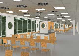

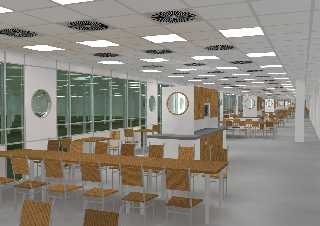

Tested POV radiosity with high quality settings:
     pretrace_start 0.080
     pretrace_end   0.010
     count 800
     nearest_count 20
     error_bound 1.0
     recursion_limit 6
     low_error_factor .5
     gray_threshold 0.0
     minimum_reuse 0.015
     brightness 1
     adc_bailout 0.01/10
     normal on
There are still black artifatcs in scene, I'll try to use always_sample
no...
Render time 230h 15min on Thund-850, res 1250x884.
Regards
Disnel
Download 'radiosity1.jpeg.jpg' (130 KB)
Preview of image 'radiosity1.jpeg.jpg'
From: Chris Huff
Subject: Re: Radiosity test (~130kB)
Date: 24 Feb 2001 10:01:12
Message: <chrishuff-BF5500.10001924022001@news.povray.org>
Maybe some variation in the ceiling light brightness, and make some of
the lights dark or just dim, like the flourescent lights are going out.
I've never seen this many lights, all the exact same brightness. Maybe
have one row turned off, with the cover open on one panel.
That, and a more interesting texture for the floor...scuff marks,
stains, etc. The chairs look too even, try making it look like they were
set up in a hurry. Maybe have one pushed out from the table, like
someone used it and forgot to push it back in. And the wood texture
needs some work.
230h 15min? Ouch...
Date: 24 Feb 2001 10:08:18
Message: <3A97CE61.6059BAAF@gmx.de>
Some thoughts:
-nearest_count 20 does not make sense according to the docu, because it's
limited to 10.
-recursion_limit 6 is probably much higher than necessary and uses a lot
of memory and time.  3 should suffice in most situations.
-error_bound 1.0 is quite high.  Lower values could lead to more realistic
shadows below the tables and chairs.
> no...
Where are those artefacts? I can't see them.

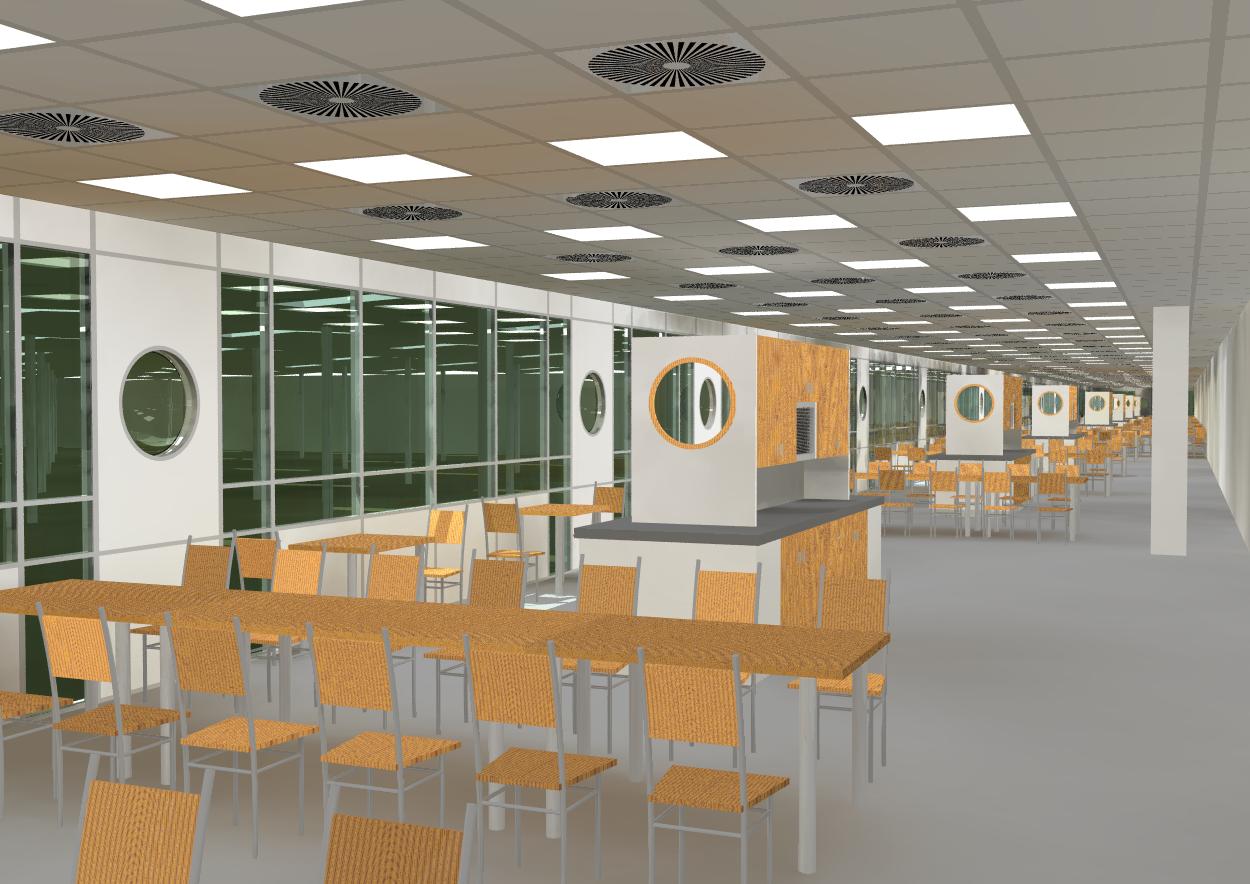

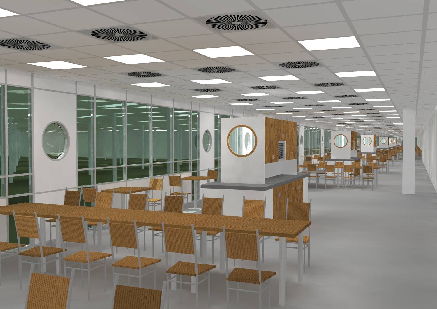

From: Disnel
Subject: Re: Radiosity test (another image, 150kB)
Date: 24 Feb 2001 11:11:13
Message: <3A97ECEB.7030303@hlavacek-partner.cz>
> needs some work.
Good ideas, Will try it. This was done in one day, because it was for
my employer and he wanted it in one day. Now I'am playing with it...
> 230h 15min? Ouch...
First render was done in 6h 48min with theese settings
    pretrace_end   0.010
    count 200
    nearest_count 5
    error_bound 0.5
    recursion_limit 2
    low_error_factor .5
    gray_threshold 0.0
    minimum_reuse 0.015
    brightness 1
    adc_bailout 0.01/10
    normal on
Image follows, now I thick, if it was not better .....
Download 'view5.jpeg.jpg' (151 KB)
Preview of image 'view5.jpeg.jpg'
From: Disnel
Date: 24 Feb 2001 11:15:11
Message: <3A97EDE7.2040002@hlavacek-partner.cz>
> limited to 10.
It is in offical docs and the result is some fixed length array, MegaPOV has the same
array?
Will try.
Now I remember, that I created another version with "lower quality" settings but with
EB 0.5, it had better shadows at the floor...
At the wall above windows.
> Christoph
From: ddombrow
Date: 24 Feb 2001 11:39:14
Message: <3a97e3b2@news.povray.org>
This is great! I love everything but the wood textures. They just seem wrong
for some reason.
Dan D.

From: Ken
Date: 1 Mar 2001 23:55:49
Message: <3A9F280D.2BD0FC44@pacbell.net>
> for some reason.
The grain size is much too large. Like the wood was taken from trees
with a 50ft diameter.
Date: 2 Mar 2001 16:49:14
Message: <3AA014E4.58001BD1@faricy.net>
Ken wrote:
> > for some reason.
I don't know. At any rate though I think there is not enough curvature, the
uniformity makes it look like it came from a huge tree.
