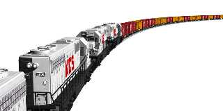

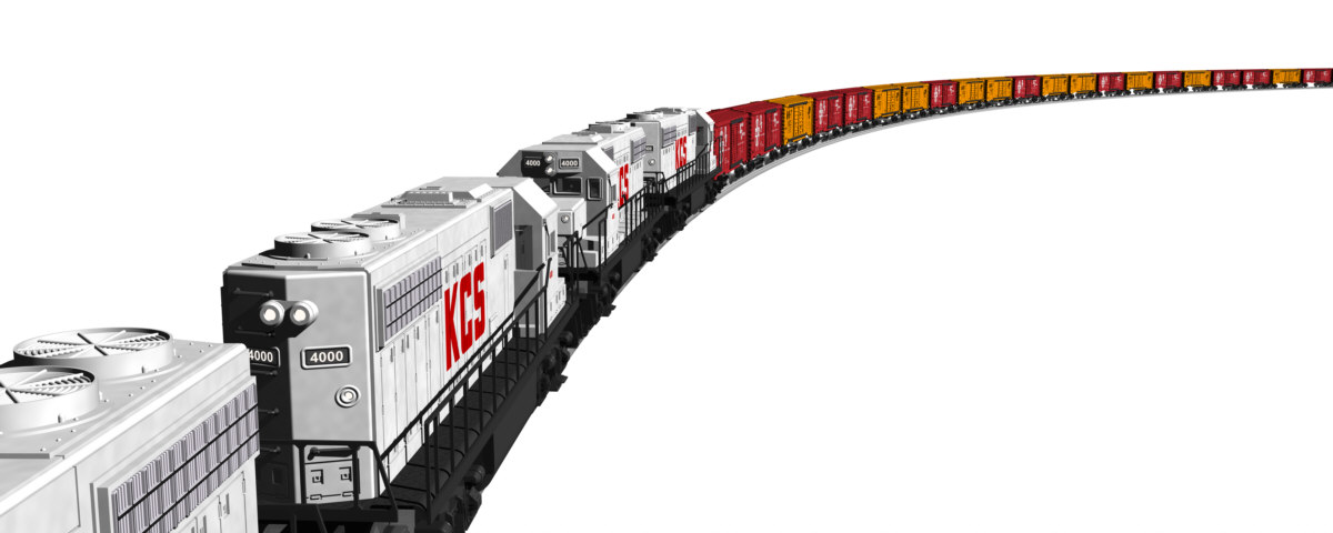

Originally rendered at 5000x2000 aa0.3, took 12h 48m 59s and 76,767,231
bytes.
Once again I forgot to add the horns on top of the locomotive (the
actual one is missing them too). And the "random" function seems to have
made fairly un-random results yet again.

Comments on ghost train?

The engines should have different numbers on them.  Good choice of bridge
famous, same guy who made that tower in Paris.  It doesn't have to look like

Yep. That'd be a bit of work though, I suppose I could split the larg image_map
into the KCS part and the number, and make multiple number ones. The cars all
have the same number too.

I like it, but it really needs at least this size to look good.  The final
scene will probably render quite slow.
