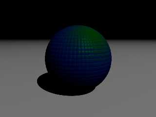

yesterday, I started a POVMan shader to do an insect "shell" (not sure
of the word).
here is the first result.
it needs more work to find the right colours and to make the surface
finish more realistic.
2 questions:
- I'm not sure of my shader version of the "metallic" keyword... I
multiplied the specular by the surface colour...Am I right ?
- I'm using little spheres to do the big sphere. When I increase the
radius of the spheres, the rendering time increase a lot ! Is it normal
           David
union {
#local maxI = 64;
#local angleI = 360.0 / maxI;
#local maxJ = 32;
#local angleJ = 180.0 / maxJ;
// here is the radius ! times in '( )'
#local dotR = 0.5;  // 0.3 (25 s)   0.4 (48 s)   0.5 (1 min 25 s)
#local sphereR = 2.0;
#local ii = 0;
#while (ii < maxI)
  #local jj = 0;
  #while (jj < maxJ)
    sphere {<0.0, 0.0, 0.0>, dotR
      translate sphereR * x
      rotate (-90 + (jj * angleJ)) * z
      rotate ii * angleI * y
    #local jj = jj + 1;
  #end
  #local ii = ii + 1;
#end
  texture {
    pigment {
     shader {
        shader_file "Test05.slp"
        "basicColor" <0.0, 0.0, 1.0>
        "highlightColor" <0.0, 0.3, 0.0>
        "specularCoef" 0.7
        "specularRoughness" 0.01
color rgb 1.0
  translate (sphereR + dotR) * y

All I saw was a solid black sphere - had to open it up and play with the
gamma to see anything :)

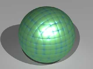

would it not be possible to achieve this effect in povray using the pillow
normal?
yes, it's dark but on my computer, it is good...

i ment quilted :)
#declare Material1 =
   material  // Material1
      texture
         pigment
            quilted
            control0 0.2
            control1 0.2
            color_map
               [ 0.0     rgbft <0.583333, 1.0, 0.583333, 0.0, 0.0> ]
               [ 0.5     rgbft <0.291667, 0.739567, 1.0, 0.0, 0.0> ]
               [ 1.0     rgbft <0.0, 0.0, 1.0, 0.0, 0.0> ]
            scale  0.2
         normal
            quilted , 0.548
            control0 0.2
            control1 0.2
            scale  0.2
         finish
            ambient 0.172633
            diffuse 0.2158
            brilliance 1.729
            phong 1.0
            phong_size 17.216667
            specular 0.3453
            roughness 0.060133
            metallic 1.0

but, the effect I want is a surface wich color changes with the incident
light !!
in my picture (I know, it's only a picture, an animation is in progress...)
the green tint is dependant of the light source direction.
as I said, I have to work on it to get the right colours and finish but,
the "spirit" is here !
      David
