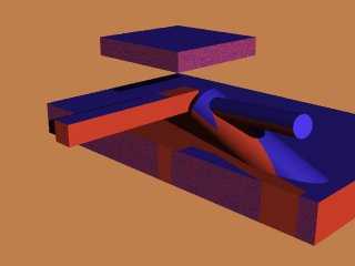

referring to the discussion in povray.newusers, i tried to make a pattern
testing if there is something 'above' the evaluated point.
syntax right now is:
pigment {
  project <vector>, object
  [color 1]
  [color 2]
I called it 'project', because it's like something being projected on the
object.  Together with megapov's slope pattern it could do what Marc
wanted.
Comments and suggestions welcome of course.

I don't get it. Please post a simpler example... perhaps on a cylinder or a
sphere alone on a plane.

I think that will help a lot. 'object' is the object against which the
pattern test?
Shouldn't the foreground side of the bottom box and the sides of the
floating box be all red? Or was your "projection-vector" not straight
<0,1,0>?
Now were can I get it? ;-)
Thanks a lot,
Marc-Hendrik

Marc-Hendrik Bremer wrote:
> WOW! That was really fast!
> pattern test?
Yes.
> <0,1,0>?
If the projection vector and the surface are parallel, things do not work
very good, so it gets spotted.  Just like doing 'trace()' right across the
side of a box.
Well, i did not yet test it very detailed, maybe also want to change some
things again, so i don't want to publish it right now.  If you like to use
it for a certain project, i can send you a copy via pm.
That would not be very meaningful, just their 'shadows' on the plane and
different colors for upper/lower side of the objects.
Just imagine where the objects get white when it snows...
Or in other words: Viewed from above with orthographic camera, everything
is blue, the whole rest is red.
Subject: Re: 'project' pattern (10k)
Date: 13 Jan 2001 17:05:50
Message: <3A60D00F.5BB7DC53@faricy.net>
Ah, now I get it. I wasn't sure what it did either.

This looks very similar to a simple version of a "visibility" pattern I
was working on once. I used multiple samples to allow a blurred result,
and my pattern was mainly to be used for a curvature pattern to make
things like "patina" in concave areas on a copper sculpture.
The proximity pattern could probably be used for this too, using the
sample_weighting feature (though I'm not sure that made it into
MegaPOV). Both of these would be very slow, though.
The "project" keyword doesn't seem very intuitive, though...maybe it
should be added to the "object" pattern instead. Or "visibility". :-)
I also thought of using several samples, but it was a bit comlicated for
me right now :-)
Sounds like a good idea, although i also thought of making the value
proportional to the distance of the 'ceiling'.
