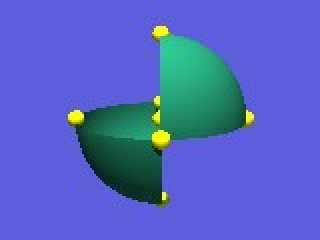

Why can't I get a working superellipse?
See code below and image below.  It looks like I'm losing two quadrants
of the s-e. Note that when the n2 is changed to 1.0 I get a nice sphere.
I then read in a web page for CS from U of Western Australia:
http://www.cs.uwa.edu.au/undergraduate/units/600.105/Lab6.html
> Note for this representation to work `exponentiation' must be defined
as
>      p                   p
>    x   =  sign(x) |x|
> Where the sign function returns +1 for +ve x, 0 for 0 x, and -1 for
-ve x.
> This allows exponentiation to `work' for  arbitrary x and p.
I tried coding this into my parametric using the abs() function, BUT
mega said I had too many parameters.....
I remember asking about exactly how povray did the exponents ages ago,
and perhaps here we have a concrete problem. Any pointers?
#declare n1=1;
#declare n2=0.99;
parametric {
                function
               (cos(u)^n1)*(cos(v)^n2),
               ((cos(u)^n1))*(sin(v)^n2),
                ((sin(u))^n1)
                <-pi*1,-2*pi>, <pi*1,pi*2>
                <-20,-20,-20>, <20,20,20>
                accuracy 0.001
                precompute 15, [x,y, z]
                pigment{SeaGreen*0.8}
                finish{ambient 0.3}
Download 'superelllipse.jpg' (3 KB)
Preview of image 'superelllipse.jpg'
From: Tor Olav Kristensen
Subject: Re: Megpov: how to do a superelipse? Do we need x^p=sign(x)*|x|^p?
Date: 3 Jan 2001 20:49:01
Message: <3A53D643.959D0047@online.no>
> as
> >      p                   p
> >    x   =  sign(x) |x|
> -ve x.
See code below.
Maybe it is done like this ?
x^n = exp(n*ln(x))
If so, then ln(x) may not be defined for x <= 0
I'm too tired to write more, so I'm going to sleep now.
Regardzzzzz,
Tor Olav
mailto:tor### [at] hotmailcom

From: Greg M  Johnson
Date: 4 Jan 2001 09:08:41
Message: <3A548297.54B63D54@my-dejanews.com>
Chris Huff wrote:
> Uh, I think "x^n = pow(x, n)" is more likely...
And is that undefined for  negative x and noninteger n?  That would
explain my missing quadrants on my superellipsoid. Will try Tor's code,
but have you any examples of working s-e's, too?
Date: 4 Jan 2001 17:06:21
Message: <3A54F274.BD9EC2D5@my-dejanews.com>
Chris Huff wrote:
> It is defined as "x raised to the power of n", and works fine with
> negative x and fractional values of n.
> > That would explain my missing quadrants on my superellipsoid. Will
> > try Tor's code, but have you any examples of working s-e's, too?
> Not for parametrics...I never messed with them very much. I think your
> problem is more of a problem with the parametric shape than the function
> evaluation. For isosurfaces, I usually use something like:
> function {Radius - sqrt(x^c1 + y^c2 + z^c3)}
> Which isn't the same as the superellipsoid primitive, but works.
Thanks, but just to make sure you understand that predicament.
When I set up parametric equations for a superellipsoid and set my e,n, as
<1,1> I got a perfect sphere. When I set them as <0.99, 1.0>, I got
something which was very close to a sphere where it existed but was missing
in 2 quadrants. So you see I wasn't trying to set up a sphere (hence your
suggestion for the sphere equation?) but was showing how the parametric
bombs out strangely in certain cases; my question is whether the parametric
cannot handle x^n with negative x and noninteger n.
