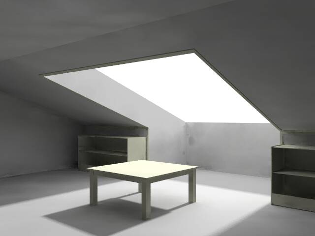

hum... strange title but this scene is a WIP. I'm using it to test some
radiosity parameters and technics, and it will be a comprative scene in
POV and LightScape when the 3D Studio MAX model will be done.
Story:
I saw yesterday a photo in one of my brother's ebenist books of a studio
like this. I decided to do it with POV.
today, at work, while my computer was unused, I launched a render. A
graphist wanted to test the same scene in LightScape (we are using it
since a few days). So, he will do the model in MAX, and he will import
it in LightScape, I will convert it to a POV scene and we will do
tests...
My question:
I used this parameters in megapov 0.6.
    pretrace_start 0.04
    pretrace_end 0.01
    count 300
    recursion_limit 2
    nearest_count 3
    error_bound 0.3
I read the "Christoph's Page", I tried various values for radiosity but
I still have this dark patches in the corner of the window.
and before, with megapov 0.5, I got dark circles even with a high count
                   Thanks for helping...
                           David

From: Greg M  Johnson
Subject: Re: radiosity inside ! (WIP, Test, Comparative, 15k)
Date: 6 Nov 2000 09:35:50
Message: <3A06C078.B4E945AF@my-dejanews.com>
Well, the patches actually make it look a bit more real, as if the sheetrock
person or painter were a bit sloppy.
Date: 6 Nov 2000 09:50:54
Message: <3A06C54E.DBCEEBAC@schunter.etc.tu-bs.de>
You could try reducing error_bound, that should remove the dark spots, but this
usually leads to a less smooth overall appearance.  Simultaneously increasing
count should reduce that but rendering time will exaggerate of course.
I didn't know radiosity changed from 0.5 to 0.6, anyone who knows ?

From: Xplo Eristotle
Date: 6 Nov 2000 14:09:22
Message: <3A0702FC.786D1049@unforgettable.com>
> Story:
> tests...
> My question:
>     pretrace_start 0.04
>     pretrace_end 0.01
>     count 300
>     recursion_limit 2
>     nearest_count 3
>     error_bound 0.3
I need to write a tutorial on low-error radiosity one of these days so I
can stop typing this stuff out... >_<
One of the problems with using an error_bound of around .3 is that the
radiosity tends to be blotchy; the effect is almost as if you were
shining a light through a screen and getting a lot of holes, or
something like the multiple-shadow effect of area_lights, only more so.
I've found that increasing error_bound will make the blotches larger and
softer, and at the default error_bound of .6, they blend together well
enough as to all but disappear.. but of course, with your error_bound
this high, you won't get the neat shadows.
If you want to use these settings more or less as they are, it's crucial
that you set the pretrace_end low enough that you're getting 2-pixel
radiosity blocks (try something around .005). This will help smooth the
blotches. Also, your nearest_count is way too low; with an error of .3,
you should leave it at default. (You could even increase it to the max
of 20, but I don't think this will help.) Set low_error_factor to 1,
which should make the pretrace a little faster without hurting quality.
If you still get unacceptable dark artifacts or the smoothing still
isn't good enough, and you have a crapload of RAM, you can use a trick
to make the artifacts smaller than a pixel (which gives extremely smooth
results, if you follow me). Set your error_bound to .03, nearest_count
to 1, low_error_factor to 1, increase your count to, hmm, 500 or so for
this scene I think, and adc_bailout to 1. Pretrace_start and _end can be
set to anything you find convenient; with these settings, they have no
useful purpose other than giving you a mosaic preview and waste a lot of
time that could be used for rendering.
-Xplo

From: gemelli david
Date: 7 Nov 2000 03:16:16
Message: <3A07BAA1.D54316D1@xlstudio.com>
> I'd love to see the results of your suggestions.  It would be very
> interesting to see both the low-quality smooth rendering and the
> high-quality-extra-slow version.
> -Nathan
Let's go !
Params:
    pretrace_start 0.04
    pretrace_end 0.01
    recursion_limit 2
    error_bound .03
    nearest_count 1
    low_error_factor 1
    count 500
    adc_bailout 1
Render in progress !
              David

From: Paul Blaszczyk
Date: 9 Nov 2000 07:15:04
Message: <3A0A954A.1BF93AD@alpharay.de>
Hi,
>  Params:
>      pretrace_start 0.04
>      pretrace_end 0.01
>      recursion_limit 2
>      error_bound .03
>      nearest_count 1
>      low_error_factor 1
>      count 500
>      adc_bailout 1
Use a recursion_limit of 3 or 4...the darker edges must be brighter and
it will look much better as at 2  :-)
Nathan:
it is right, that the maximum of recursion_limit is 6?? I've rendered a
test-scene with several values for
recursion_limit...after 6 all rendering times (also at 100 and 150) were
the same as at 6.
Paul
Date: 9 Nov 2000 17:07:45
Message: <3A0B2152.A5A539F8@unforgettable.com>
Paul Blaszczyk wrote:
> Hi,
> >  Params:
> >      pretrace_start 0.04
> >      pretrace_end 0.01
> >      recursion_limit 2
> >      error_bound .03
> >      nearest_count 1
> >      low_error_factor 1
> >      count 500
> >      adc_bailout 1
I'm not so sure about that.. in a number of my tests, the differences
between 2 and higher levels were noticible, but not especially significant.

> the same as at 6.
I would think that the amount of "light" given off from each bounce
would get smaller and smaller.. perhaps, at that high of a recursion
level, the extra bounces are contributing so little to the scene that
they don't show up at all.
-Xplo
