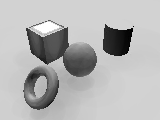

The image bellow was designed in Moray and rendered in MegaPov. I did
not use the Moray setting, only the following:
radiosity {
    count            300
All objects have the following material:
#declare Material1 =
   material  // Material1
      texture
         pigment
            color rgb <1.0, 1.0, 1.0>
       finish {
         ambient 0
         diffuse 0.8}
There is a plane above the scene to reflect the rad lighting back down.
My question is, why do the 3 objects have no radiosity shadows? I know
that since there is no direct lighting on them they will not cast ver
prominent shadows, however there should still be a fuzzy shadow on the
ground due to radiosity. The way the image looks now is very FLAT. For
some reason I have a thing for simple radiosity images, they have some
kind of beauty, any agree?
Download 'test6.jpg' (13 KB)
Preview of image 'test6.jpg'
From: Kari Kivisalo
Subject: Re: Q's about radiosity
Date: 3 Nov 2000 21:12:18
Message: <3A03707A.C831D52A@kivisalo.net>
Lowering pretrace_end and error_bound will show the shadows. assumed_gamma
will help radiosity to work the way it's supposed to work. Set also
Display_Gamma.
global_settings{
  assumed_gamma 1.0
  radiosity{
    pretrace_start 0.04
    pretrace_end 0.01 <-
    count 100
    recursion_limit 2
    nearest_count 3
    error_bound 0.3  <-

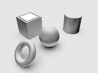

Wow that really helped thanks! At first I got a lot of blotchiness, but that
seemed to clear up if I set the error_bound a little higher, 0.5 in this case.

From: Kari Kivisalo
Date: 3 Nov 2000 21:52:10
Message: <3A0379D4.DFDB64C5@kivisalo.net>
You could up the nearest_count too.

From: Xplo Eristotle
Date: 3 Nov 2000 22:33:30
Message: <3A0384A0.9892D896@unforgettable.com>
Raising the count, dropping the pretrace_end as low as practical, and
adding "adc_bailout 1" will help somewhat with the blotchiness.
Alternately, you could raise the count up to 200-300, set error_bound to
.03, adc_bailout to 1, and drop nearest_count to 1; this should give you
extremely smooth results without taking TOO long to render (and if you
try this, I'd like to hear/see your results).
-Xplo
