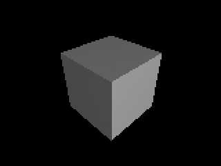

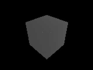

between the following two pov-codes' results.
I have no idea, hope someone can tell me why two identical objects look
different
one is a simple CSG, the other an isosurface
attached are the results...
///////////Code A start/////////////
#version unofficial MegaPov 0.6
isosurface {
        function {
                if(1 - x,0,1)+
                if(1 - y,0,1)+
                if(1 - z,0,1)+
                if(x + 1,0,1)+
                if(y + 1,0,1)+
                if(z + 1,0,1)
        threshold 0.5
        contained_by { box {<-10,-10,-10>,<10,10,10>}}
        pigment {rgb 1}
light_source {<10,14,24> rgb 1}
camera {
        location 3
        look_at 0
//////////code B start//////////////
intersection {
        plane {<1,0,0> , 1}
        plane {<0,1,0> , 1}
        plane {<0,0,1> , 1}
        plane {-<1,0,0> , 1}
        plane {-<0,1,0> , 1}
        plane {-<0,0,1> , 1}
        pigment {rgb 1}
camera {
        location 3
        look_at 0
////////END//////////////////
Download 'CornerIsoFree.jpg' (4 KB) Download 'CornerIso.jpg' (4 KB)
Preview of image 'CornerIsoFree.jpg'
Preview of image 'CornerIso.jpg'

I don't fully understand why the two objects look different, but I can
tell you that it's the isosurface that's wrong, and I can tell you what
you can do to fix it.
But you may not like the solution.
Method 1 isosurfaces sometimes have problems when the function has an
extremely high gradient, so you can fix it by using method 2, i.e. be
adding either
   method 2
   eval
or, in this particular case,
   method 2
   max_gradient 4000
The reason that you may not like the solution is that it now takes a
ridiculously long time to render the image.
Note that, for this function, the max_gradient is dependent on the
accuracy. The gradient is really infinite at the surface of the object
because the value of "if(1 - x,0,1)" changes from 0 to 1 over an
arbitrarily small distance. The smallest distance that gets considered
depends on the accuracy setting.
An alternative solution would be to generate the isosurface box from a
function that has less steep gradients, such as
isosurface {
        function { (y*y-0.5) & (x*x-0.5) & (z*z-0.5) }
        threshold 0.5
        contained_by {box <-2,-2,-2><2,2,2>}
        pigment {rgb 1}
Which is correct whether you use method 1 or method 2, and renders
quickly if you use method 1 or if you make the bounding box a reasonable
size.
Mike Williams
Gentleman of Leisure
Subject: Re: why the difference???
Date: 21 Oct 2000 02:57:54
Message: <39F13E71.63853111@schunter.etc.tu-bs.de>
