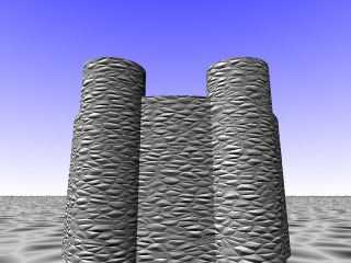

From: Anton Sherwood
Subject: Re: The Fortress of Torganswall (17 kbbu)
Date: 2 Dec 2001 02:30:43
Message: <3C09DA67.55C08C8F@pobox.com>
Ron Parker wrote:
> I'm not sure what value of form would help in this case, though.
> To change the shape of the bricks in any meaningful way pretty much
> requires metric.
I think part of the problem is that only low walls are commonly made of
such randomly-arranged rocks.  Stretching the pattern laterally (scale
<0.2,0.07,0.2>) seems to help a bit, in this very crude sketch.
But yeah, the walls ought to be smooth.  Romanesque churches have smooth
walls, a fort can too.  The lumpy `walls' you see in a lot of ruins are
the rubble core of the original walls: their surfaces were smooth.
Anton Sherwood  --  http://www.ogre.nu/
