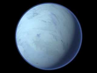

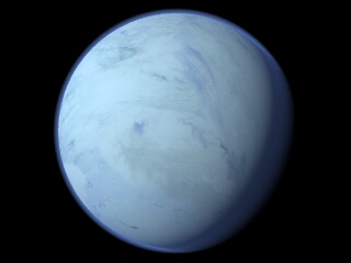

I've run into something I was wondering if someone might be able to explain.
I'm creating planets using image maps form SWMA. I want to have my clouds on
a spearate sphere so that I can have shadows from the clouds for close ups.
My problem is that if I use media as my atmosphere (using scattering and
absorbtion), the atmosphere doesn't tail off the way it should if I use a
2nd sphere for my clouds, but works fine if I just used a layered texture.
I've attached an example, where the only difference between the images is
that planet1.jpg has the clouds as just another in my surface texture, and
planet2.jpg has the clouds as a seperate sphere which is only slightly
larger in radius (1 vs 1.0001).
Thanks,
Darcy
Download 'planet2.jpg' (13 KB) Download 'planet1.jpg' (12 KB)
Preview of image 'planet2.jpg'
Preview of image 'planet1.jpg'

From: Darcy Johnston
Subject: Re: Questions about media
Date: 18 Sep 2000 01:18:16
Message: <39c5a598$1@news.povray.org>
"ryan constantine" <rco### [at] yahoocom> wrote in message
news:39C45732.DB0BBD24@yahoo.com...
> do you have to have scattering media?  personally, due to render time, i
> try to work around it.  i have a post somewhere about using emitting
> media in either a gradient or a plane pattern so only the light side is
> lit.  i also have some pretty good cloud action going on although i
> don't think i posted my final clouds.  maybe i should.  to imagine what
> i ended up with, take my last xwing pic (i think the post was called
> 'hope you aren't tired of these yet') and where it looks like the clouds
> are too bright and smooth, they are now puffy all over.
I'm not overly concerned with speed at the moment, although I may use your
idea to fix the problem as well as speed up the render. The one thing I'd
expect to miss out on is the way the atmosphere extends a bit beyond the lit
area when using scattering. But I'll try and see what I can come up with.
Thanks,
Darcy
Date: 20 Sep 2000 22:14:45
Message: <39c96f15$1@news.povray.org>
"Bob Hughes" <per### [at] aolcom?subject=PoV-News:> wrote in message
news:39c4bd24@news.povray.org...
> "Darcy Johnston" <djo### [at] inamecomNOSPAM> wrote in message
> news:39c3ec84@news.povray.org...
> | I want to have my clouds on a spearate sphere
a
texture.
> Most probably a intervals thing.  Since the second spheres shadow has to
be
> figured for.  Try increasing that one or two integers if using MegaPov and
a
> few more if using official POV-Ray.
Well, I finally got around the trying it out and bumped my interval value
from 5 to 15 with no difference in the effect.
Should 15 be high enough?
Do any of the code hackers have any ideas as to why this might be?
Thanks for the suggestions,
Darcy
