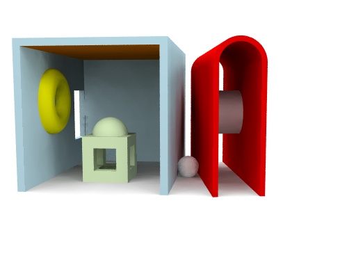

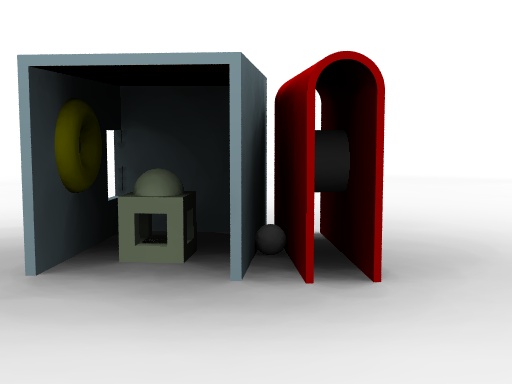

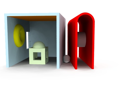

In another thread there was a discussion about whether a higher recursion
level would make the image look better in the "illuminating hemisphere"
scene. It was also questioned, whether it is possible to speed up the
radiosity calculations using the aid of area lights without changing too
much the resulting image.
  Well, I decided to try.
  The first image uses radiosity recursion level 1.
  The second image is the exact same scene file, with the only difference
being the recursion level changed to 2.
  The second image took about 1 hour and 5 minutes to render. I tried to
help the radiosity with area lights, so I created a hemicube of light
using 5 area lights and then reduced the radiosity quality settings to
speed it up.
  The resulting image is the third one. It took about 40 minutes to render.
Download 'rtest1.jpg' (27 KB) Download 'rtest2.jpg' (27 KB) Download 'rtest3.jpg' (26 KB)
Preview of image 'rtest1.jpg'
Preview of image 'rtest2.jpg'
Preview of image 'rtest3.jpg'

Seems to prove at least one thing to me, that light sources are necessary to
get a good render when using radiosity.  The white floor plane however has
lost most of the shadows but that must be from the full coverage of
lighting.
The contribution of illumination from the objects themselves in the 2nd
rendering is rather artificial looking but otherwise shows that a recursion
of 2 really ups the radiosity.  Which leads me to ask, did you do a
recursion of only 1 with the lighting?

  Of course not. The whole idea with the third image was to compare it to
the second one, so it uses recursion level 2 as well. However, I had to
reduce the diffuse value of the objects to get the same brightness, but
that's not a surprise.
  By the way, the shadows around the objects in the recursion level 1 image
may look cool, but I think they don't correspond to reality and are in fact
an artifact caused by the unrealistically low recursion level.
  Of course sometimes an unrealistic effect can look artistically better
than the physically accurate result.

Where does the red on the *inside* of the box come from?
From: Warp
Subject: Re: "Illuminating hemisphere" scene tests
Date: 1 Sep 2000 10:52:39
Message: <39afc2b6@news.povray.org>
: 	Where does the red on the *inside* of the box come from?
  From the pigment.

	Euh, what pigment? It seems to be a uniform light blue... or did you
give it a more complex pigment?

I also see that in the second and third images, the ceilling looks red.
 11:06pm  up 11 days,  3:24,  2 users,  load average: 1.09, 1.09, 1.05
From: Tony[B]
Date: 2 Sep 2000 11:37:25
Message: <39b11eb5@news.povray.org>
Looks orange to me...

  Because that's the pigment of the ceiling. Comprende?
