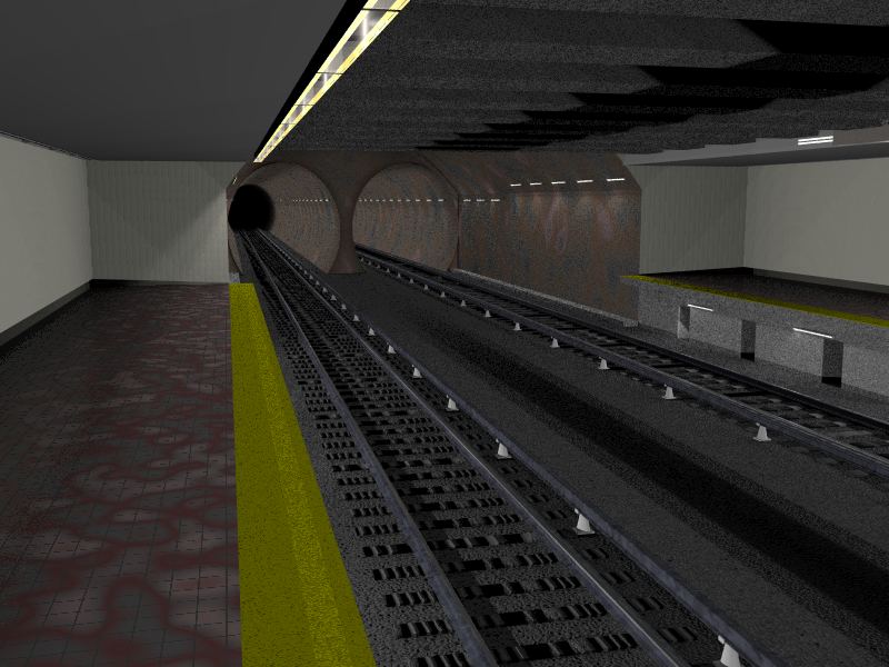

After a few lighting and texture changes.
This one without radiosity: 34 hours 40 mins to render
The textures on the tunnel walls still isnt right, Seems too bright.
I liked the progress and thought I'd share it.
Alan

Looks quite ok, good job on the modelling work.
some points:
-The textures look quite grainy, not so good IMO.
-there are very few real shadows due to the many light sources, which makes
things somewhat flat.
The rendering time looks awfully long for such a scene.  Maybe try removing most
of the light sources and using radiosity with some high ambient objects for the
lights instead.

When I first looked at this I thought the tracks were above
the platform, and that the space between the tracks was a
vertical wall (perhaps with an I-beam profile).
Once I followed the lines into the tunnels all became clear,
but I think something needs to be done with the lighting or
camera angle or something (sorry I only know how to say
what is wrong, not how to fix it :-)
I really like this work.  Thanks for posting.

This morning, I took a closer look at the real tunnels and the tunnel
lighting is wrong, the small tunnels only have lights on the 'outside'.
You say it looks flat and your right, but the lighting in the real world of
this isnt really very good either. Using area lights for each flourecent
light slows things down a lot, and I'm still trying to get the textures
right.
The scene still needs the cables, pipes and wires that run through the
tunnels.
Thanks for the input.
Alan

I would really suggest to try radiosity and use high ambient finish for the
light objects.  Probably render time could be even shorter than now.
Maybe have a look at warp's radiosity samples:
http://www.students.tut.fi/~warp/pics/Radiosity_test/
http://www.students.tut.fi/~warp/pics/Radiosity_test2/

I thought radiosity added time to the rendering. I have the radiosity
settings in the code, but they were not used this time. Last time I used
radiosity, after 48+ hours the scene was not even 60% complete.
The light objects use media and a ambient of 2.0
Thanks for the links, I'll definitly take a look.
Alan

For most scenes, it does. But if you have a large number of lights,
using radiosity for lighting could be faster, especially when they are
area lights. The idea is to remove all or most of the lights and use
radiosity to simulate true area lighting.
> I have the radiosity settings in the code, but they were not used
> this time. Last time I used radiosity, after 48+ hours the scene was
Are you using MegaPOV? Are you trying to use settings from the official
version in MegaPOV? Are you using MegaPOV in addition to the area
lights, or as a replacement for them?
MegaPOV radiosity is usually a lot faster, but it takes different
settings.

Don't forget to suppress light buffers when you add many lights. I ran
into strong memory issues while doing a similar scene:
http://perso.club-internet.fr/wozzeck/gl_merc_1.html
... but everything went right after I added Light_Buffers=off
> tunnels.
Good idea. Gilles Tran's macro, perhaps?

And the cables and pipes all have dust on them that you can see very
clearly from the train and from the platform.  That's not going to
be easy, faking it with layered textures is your only hope.

Some great ideas here, I'll need to explore them, and I am Using MegaPOV 0.5
Thanks
