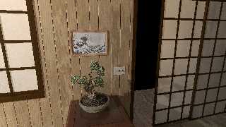

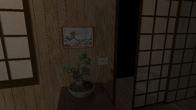

I say "sorta final" because, in actuality, there's quite a bit more that
could be done with this scene, both in terms of render quality and
additional modeling/texturing, but the pic here took over 42 hours to
render as it is, and until I get a much better computer, this is as much
work as I'm willing to put into something that takes far too long even
to test.
Comments welcome, of course.. for all the good it'll do.
-Xplo
Download 'room.jpg' (40 KB)

42 hours for without aa ? What's taking that long apart from the tree ?
Btw, it looks very dark on my screen.
The tree was having some bounding problems, and manual bounding didn't
seem to having any effect (literally, there was no change). So the
middle third of the picture was really slow.
The table directly underneath it was even worse, because (I think) of
the reflection blur.
I was going for something like realistic lighting, and with all three of
the lights on (you can't see them because they're overhead, but there's
three of them), making the lighting any brighter washed out the color of
the wooden walls. I suppose I could have increased the light intensity
to simulate pupil dilation (or longer exposure, whatever), but you know,
even with those measures, a real-life dimly-lit room still looks dimly-lit.
I wonder what "photographic" post-processing, as was discussed on here
some weeks back, would do to the image.
Try looking at it on a black background, and with the lights turned down
to match the illumination in the picture.. the difference is really dramatic.
-Xplo

Subject: BTW, my gamma is 1.8
Date: 27 Oct 2000 03:07:24
Message: <39F92AB4.2F177CE4@unforgettable.com>
For those of you who are on PCs and find the picture really dark, it was
created on a Mac with gamma 1.8, and most of the tones are in a range
where gamma makes a very noticible difference. I could post a gamma 2.2
version, if I can figure out how to do proper gamma correction in
Photoshop (I'm *certainly* not going to re-render at 2.2!).
-Xplo
In such cases i would do test renders without the tree so i could adjust the
lighting situation and only add it for the final render
I don't know the effect in this special case apart from making things even
slower, but it's often worth trying radiosity in indoor scenes ...
I had a look at the picture's histogram and saw that it only uses values below
103.  When doing color correction after the render, there are always losses
because of the limited accuracy (8 bit per channel), especially with further
reduced color space like here, and 16 bit pictures are only supported by very
few programs right now.  (That matter was discussed before as you mentioned)
I also tried Photoshop's Auto-Correction (i don't know the exact name in
english) and the result was quite interesting.
Which is, in fact, what I did.
Um, it DOES have radiosity. That's not ambient picking up the shadows.
-Xplo

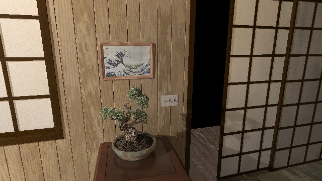

Subject: Re: Japanese room - much lighter version
Date: 27 Oct 2000 16:29:02
Message: <39F9E677.276481C4@unforgettable.com>
Three lights like this would make the room painfully bright, but for
those of you who find my original image too dark, here's a much brighter
version, courtesy of Photoshop.
-Xplo
Date: 27 Oct 2000 17:03:05
Message: <39f9ed89@news.povray.org>
Holy non-antialiased batman!
now though i can see the tree better, and the blurred reflection wasn't
visible at all before.
muchbetter.
ross
