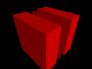

In order to make a Menger-sponge isosurface i want a function that will
give me a triangular wave.
I tried using floor, but I get a plane at x=0 where it should be empty
space. Is this a bug? What would be a better way to get a triangle wave?
isosurface {
   function {
      abs(x/6+3-floor(x/6+3)-.5)-2/6
   contained_by { box { -3,3 } }
   pigment { color rgb x }
Download 'mengeriso.gif' (5 KB)
Preview of image 'mengeriso.gif'

I can't imagine why you might possibly think that might lead to a
triangle wave. Any function that only involves x can only ever produce
results that are made up of x planes.
Let's try so solve this equation
    abs(x/6+3-floor(x/6+3)-.5)-2/6 = 0
The first thing we notice is that 3-floor(3) is always zero, so we can
get rid of the "+3"s.
    abs(x/6-floor(x/6)-.5)-2/6 = 0
Now, since x goes from -3 to +3 (due to the contained_by box) we can see
that x/6 goes from -0.5 to +0.5, and floor(x/6) can only be 0 or -1.
When x>0, floor(x/6) is zero, the equation reduces to
    abs(x/6-.5)-2/6 = 0
which has solutions at x=1 and x=5. The x=5 solution is outside the
contained_by box.
When x<0, floor(x/6) is -1, the equation reduces to
    abs(x/6+.5)-2/6 = 0
which has solutions at x=-1 and x=-5. The x=-5 solution is outside the
contained_by box.
So what you see is the two planes x=1 and x=-1.
If you want a sawtooth wave, try starting with something like
   function { y - x + floor(x) }
If you want a symmetrical triangle wave, try starting with
   function { y - abs(x-floor(x)-0.5) }
Mike Williams

Sorry, I wanted a triangle wave if said equation equals y, not if it is less
than or equal to zero. That way, by making it less than or equal to zero I
get a regular pattern of solid space and empty space. That equation should
give me what I want, but I was wondering why there was a plane at x=0:
x-floor(x):
      y
-------------x
dividing by 6 increases the wavelength, adding 3 translates it, subtracting
the .5 makes half of it go below the x-axis, and taking the absolute value
inverts the lower portion to form the parts with negative slope:
     y
-----------x
So I'm thinking perhaps it is a bug.
Anyway, I got what I wanted using modulo so it doesn't matter.

So, you meant to type
isosurface {
   function {
    y - (abs(x/6+3-floor(x/6+3)-.5)-2/6)
But this doesn't have a plane at x=0.
Although you added +3, you also subtracted floor(3), so these cancel
out, so it doesn't get translated.
Mike Williams
Gentleman of Leisure

No, I meant no y. I want the equation to return a value consistent with a
sawtooth wave as x changes. The way I want to use this function is to create
alternating solid and empty spaces.
It does when the y is removed.
Hmm, you're right, would be +(0..1) regardless of wavelength... but I checked and
the waveform was still what I was looking for.

If you remove the y, then your surface will always be only a series of x
planes. Typing
 function { abs(x/6+3-floor(x/6+3)-.5)-2/6}
Gives you the surface described by
If you want the surface
 abs(x/6+3-floor(x/6+3)-.5)-2/6 = y
You have to move the y to the left hand side of the equation before
turning it into a function.

But that's what I want. I'm saying I want f(x) to be a sawtooth wave, not the
surface itself. (Actually, all values below zero would be considered inside the
object too.) Problem was I got an *extra* plane; see the original picture.
