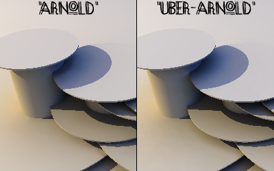

While working on a scene, I noticed that I seemed to be getting tiny
patches of really bright illumination where they didn't belong. I tried
a few radiosity tweaks, but nothing made them go away, so I opened up my
Arnold disks scene and made all sorts of radical changes to the
radiosity settings, when completely by accident I discovered an
interesting set of values even MORE radical than the current "Arnold" settings.
Below are two views of the disks, rendered with different radiosity
settings. The one on the left uses what I believe to be fairly typical
"Arnold" settings:
		brightness 1
		count 100
		recursion_limit 1
		gray_threshold .1
		error_bound .3
		pretrace_start .01
		pretrace_end .01
The one on the right uses my tweaked settings:
		brightness 1
		count 200
		recursion_limit 1
		gray_threshold .1
		error_bound .02
		nearest_count 1
		adc_bailout 1
		pretrace_start 1
		pretrace_end 1
(The titling font is mine. Neat huh?)
As you can see, the one on the right has smoother gradation in the
shadows; the Arnold settings produce a dark shadow with a definite cutoff.
Render time was four times longer with the new settings.. but some crude
preliminary testing shows that for complex scenes (read: "almost all of
them"), the new settings can be significantly faster, depending on how
they're tuned.

Umm, I'd have to say that I can't see any difference between the two views,
apart from the logo (or is that the idea?).

And yes, I could see the differences in your renders although it takes some
scrutiny.

I don't see any difference either. Xplo?

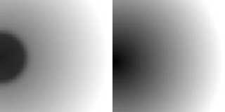

The error_bound .3 render doesn't have a very smooth shadow compared to
the other one. I've attached an exaggerated illustration of the
difference so you can see what to look for.

I can see the difference in your original post. The difference in shading is
not obvious, but you can make it out. The images you just posted obviate
your point succinctly.
Grim
