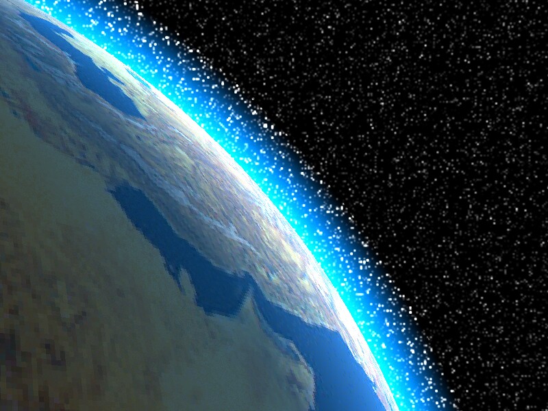

Hi Tracers!
Finally, by trial and error, I found out how to render the atmosphere
from orbit correctly... but now a new problem occurs.
As you can see, I used a sky sphere with stars - and all stars behind
the media-filled sphere which makes up the atmosphere appear exaggerated
in size and brightness. Is there any way to avoid this effect?
Here the POV code for the "air" in the atmosphere sphere:
#declare Air =
   material  // Air
      texture
         pigment
            color rgbft <1.0, 1.0, 1.0, 1.0, 1.0>
      interior
         ior 1
         media
            scattering
               4 ,  rgb <0.0, 0.5, 1.0> // isotropic scattering
            density
               spherical
Download 'afghan sunrise.jpg' (133 KB)
Preview of image 'afghan sunrise.jpg'

I am not going to be much help with your problem, media just acts that way
sometimes, but I wanted Ken to note the proper way to indent and arrange
code. Especially note the double spaced close-braces at the end.

Subject: Re: Afghan Sunrise (133K) - problem with star background
Date: 23 Sep 2000 15:59:05
Message: <39cd0b89@news.povray.org>
news:39CCB00D.1012C1E3@ndh.net...
Try adding absorption <0.5,0.5,0.5> to media and adjust the vector to fit
what you need for color.  Also might want to try removing the transmit (rgbf
<1.0,1.0,1.0,1.0> instead) from the container pigment as well since that can
enhance background object colors causing a brightening.
This will cause a darkening of the media so scattering will need to be
changed to counteract.
From: Jörg 'Yadgar' Bleimann
Date: 23 Sep 2000 18:48:05
Message: <39CD0468.9E6CC15F@ndh.net>
ryan constantine schrieb:
> sorry to spoil it for you bill, but i think he's using moray.
Yes, I in fact use Moray... it's a good aid to control whether an object is
inside the field of view or not, in "pure" POV-Ray I found that VERY difficult
to do...
But nevertheless I also feel uncomfortable with Moray in some respects,
especially when it comes to the different coordinate system (z up instead of
y...), and still there are some features (like sky spheres) which are not even
supported by the 3.2 version...
See you in Khyberspace!
Yadgar
Subject: Re: Afghan Sunrise (133K) - stars now correct, but surface in twilight
Date: 23 Sep 2000 18:48:08
Message: <39CD08B0.96EEB8B1@ndh.net>
I removed the translucency statement, and the distortion of the stars
disappeared... with enhanced scattering color (I used a multiplier
factor of 10!), the media, i. e. the gradiented fringe along the
horizon, also
retained its brightness... but, whether I use your proposed amount of
absorption
or no absorption at all, now the Earth's surface appears in dull
twilight,
just as if the sun still was below the horizon (which is not, in fact,
it's about
future
versions I will rotate Earth a bit back, so that the sun actually can be
seen
(using a customized lensflare effect) slightly above the horizon).
Just increasing the sun's brightness only resulted in an "overexposure"
of the media, but not in a lit surface with realistic contrast... how to
fix
that?
Yadgar
From: Mark Wagner
Date: 24 Sep 2000 03:06:52
Message: <39cda80c@news.povray.org>
There's your problem.  Remove either the F or the T component.  Also, try
increasing the "diffuse" component of the planet's finish.
Mark
From: sacrofts
Date: 24 Sep 2000 04:47:58
Message: <39cdbfbe@news.povray.org>
I don't know if this will help, this is an adaptation from a tutorial I
was following.  I vaguely remember some improvement in making the
absorption media and scattering media in separate declarations.  The
tutorial advised dividing the color statement by the scale used to match
the radius of the atmosphere.
---code
#declare atmos = media {     file://atmospheric scatter
   scattering {4, rgb <.6,.5,1>/8280.5}
   intervals 1        file://set to 10 for final
   samples 2, 20
   confidence 0.9999
   variance 1/1000
   density {
      spherical
      color_map{
         [0,    rgbf <0,0,0,1>]
         [.075, rgbf <.75, .75, .75, 1>]
         [.15   rgbf 1]
         [.6,   rgbf 1]
         [.61,  rgbf <0,0,0,1>]
         [1,    rgbf <0,0,0,1>]
scale 8280.5}
#declare atmos2 = media {     file://atmospheric absorption
   absorption rgb <.6, .5, 0>/8280.5
   intervals 1      file://set to 20 for final
   samples 2, 20
   confidence 0.9999
   variance 1/1000
   density {
      spherical
      color_map{
         [0,    rgbf <0,0,0,1>]
         [.15   rgbf 1]
         [.6,   rgbf 1]
         [1,    rgbf <0,0,0,1>]
scale 8280.5}
sphere {0, 8280.5 hollow    file://atmosphere upper layer (low
refraction)
   pigment{rgbt 1.0}
   interior {ior 1.000292 media {atmos} media {atmos2}} file://050
Date: 24 Sep 2000 16:58:17
Message: <39ce6ae9@news.povray.org>
"sacrofts" <sac### [at] tinyonlinecouk> wrote in message
news:39cdbfbe@news.povray.org...
I don't know if this will help, this is an adaptation from a tutorial I was
following.  I vaguely remember some improvement in making the absorption
media and scattering media in separate declarations.  The tutorial advised
dividing the color statement by the scale used to match the radius of the
atmosphere.
Do you have the URL to that tutorial available to post here? TIA if you do
because I'm sure people will want a look.
Reason I said absorption <0.5,0.5,0.5> was because of the uncertainty about
how it would fit in to begin with, so I was really just saying try
absorption.
