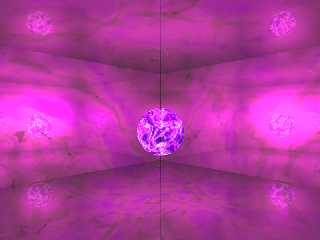

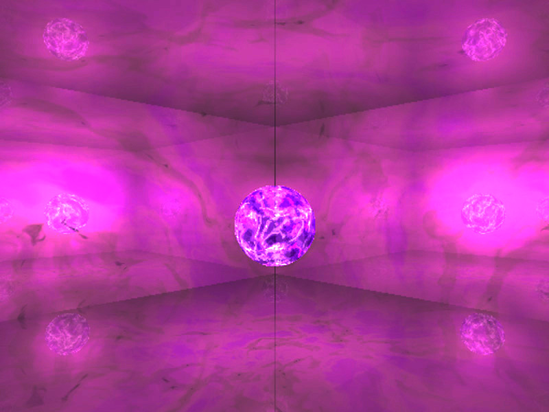

From: Wyldegod
Subject: Re: Black Sphere ???
Date: 23 Sep 2000 06:34:33
Message: <39CC8669.68E6C84B@juno.com>
Thanks for the input, Hugo.
Jack Daniels and I are just plain dumb this early morning.  I forgot the
texture in my declare when I declared it.  It works fine now so let me test
this connection and load the image.  I will keep your info in mind for
future renders as I learn more about the program.

Download 'lighteningb.jpg' (100 KB)
Preview of image 'lighteningb.jpg'

congratulations on successfully posting an image!  welcome.
> Hugo wrote:
> > Hello Wyldegod,
> > I rendered the file and see what you mean, though, it's not a shadow. It
> > also took me a little while to figure out, cause I rarely use this
> > function.
> > The problem is the "Lightening_Sphere". I don't know what you intended,
> > but remove "looks_like {Lightening_Sphere}" and the black sphere is
> > gone. Besides, the reason why it was located on the ceiling, is because
> > you wrote:
> > #declare Lightening_Sphere = sphere { <0,35, 0>, 10 }
> > When you add this sphere to the light source, the Y direction is 35+35.
> > Because the position of the light source, and the position of the sphere
> > are added. So you should declare the "Lightening_Sphere" at origin.
> > Keep POV'ing,
> > Hugo

would megapov's double illuminate work as well?
Warp wrote:
>   And if you really want the sphere to indicate the light source do the
> following:
>   a) Put your Lightening_Sphere center to <0,0,0>
>   b) Apply a "finish { ambient 1 }" to it.
