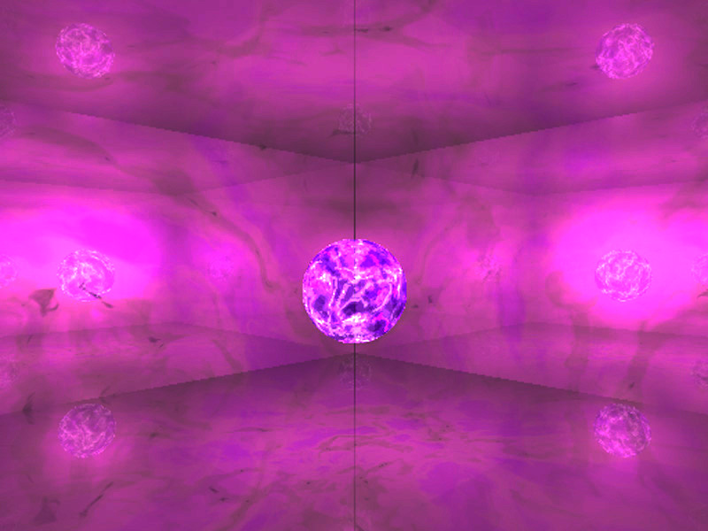

I have been using the pov 3.1 for about 3 or 4 days and I have a
question about a black sphere that appears on the ceiling in a enclosed
space I have created.
I used the lightbulb declare (slightly modified) from the tutorials to
create a lightning sphere and it seems to have created a shadowed image
of the sphere on the ceiling
#include "colors.inc"
#include "textures.inc"
camera {
   location <0, 40, -150>
   look_at  <0, 35, 0>
#declare Lightening_Sphere =
      sphere { <0, 35, 0>, 10
light_source { <0, 35, 0>
       color Plum
       looks_like { Lightening_Sphere }
union {
box { <-75, -3, 75>
      <75, 0, -75>
box { <-75, 0, 75>
      <75, 75, 73>
box { <-75, 0, -75>
      <-73, 75, 75>
box { <75, 0, 75>
      <73, 75, -75>
box { <-75, 75, 75>
      <75, 73, -75>
texture { Aluminum }
sphere { <0, 30, 0>, 10
    texture { Lightening2
    scale 20 }
It is a simple room of aluminum with a reflecting sphere of lightening
but I cannot figure out where the shadow sphere came from.
  My question is this...
Does the light source not show a 360 degree arc.  I believe that it does
and my experience with Lightwave and Studio Max leads me to believe that
it should so where is the shadow sphere coming from?
Thanks for any help on this subject.
A note for the editors--
    THIS IS A GREAT PROGRAM!!!

I rendered the file and see what you mean, though, it's not a shadow. It
also took me a little while to figure out, cause I rarely use this
function.
The problem is the "Lightening_Sphere". I don't know what you intended,
but remove "looks_like {Lightening_Sphere}" and the black sphere is
gone. Besides, the reason why it was located on the ceiling, is because
you wrote:
#declare Lightening_Sphere = sphere { <0,35, 0>, 10 }
When you add this sphere to the light source, the Y direction is 35+35.
Because the position of the light source, and the position of the sphere
are added. So you should declare the "Lightening_Sphere" at origin.
Keep POV'ing,
Hugo

Jack Daniels and I are just plain dumb this early morning.  I forgot the
texture in my declare when I declared it.  It works fine now so let me test
this connection and load the image.  I will keep your info in mind for
future renders as I learn more about the program.

And if you really want the sphere to indicate the light source do the
following:
  a) Put your Lightening_Sphere center to <0,0,0>
  b) Apply a "finish { ambient 1 }" to it.

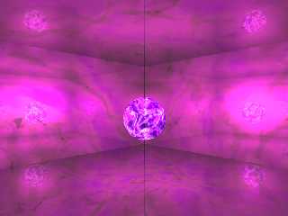

congratulations on successfully posting an image!  welcome.
Wyldegod wrote:
> Thanks for the input, Hugo.
> Hugo wrote:
> > Hello Wyldegod,
> > function.
> > Keep POV'ing,
> > Hugo
