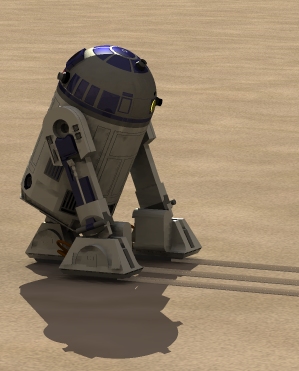

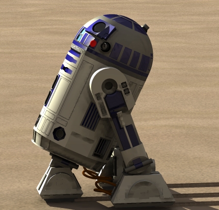

the really bright areas on r2's head goes right up to the shadow line.
why?  i don't think it should.  plus, the shadow line is rather harsh on
the head as well. i think it should be more gradual.  the songle light
source has magnintude of color*2.  is that my problem?  you can see in
the closeup that only the blue on the head has the sharp shadow, but in
the farther pic, the whole head has the sharp shadow.  i need to
decrease my error bound for radiosity.  notice a blue chunk is missing
from the middle of his leg.  that leg is a negative copy of the right
leg, but the right leg doesn't have that part missing.  any ideas why?
also, you can see in the closeup, my original tracks, then my second
version.  i have a third version that looks better.  any other
comments/suggestions/critisism?
Download 'r2d2messeduptracks.jpg' (112 KB) Download 'r2d2s33pre3.jpg' (70 KB)
Preview of image 'r2d2messeduptracks.jpg'
Preview of image 'r2d2s33pre3.jpg'

I can't help you with the problems you're describing, I just want to say
that this looks *very* good! At first I wondered which of the images were
the rendered one, and which were from the movie... Then I found out both
were rendered. Keep it up! :-)

The first one looks gradual enough to me. The second one is sharp, as you
say. This might be due to the brilliance value you used. I can't help you
with the rest. Sorry. Good work. I hope you get it just right. :)

The shadow line is most likely caused by a combination of three things in
the finish: diffuse, brilliance, and specular highlighting.  In this case it
looks like the highlight is the culprit most of all, along with a possible
negative brilliance.  And that light with color*2 isn't helping matters I'm
sure.  The strangest thing there is the plate where the electronic eye (?)
is.  Looks like a reflection but doesn't make any sense to me.
The missing part might be either translated wrong, such as not remaining
attached, or perhaps it really is a flaw in the type of part.  I can only
speculate, something I do best.

I had similar problems once (about 4 years ago) when I was making my first
Liberator-model (from Blake's 7.  I lost that version.  Harddisk crash.
Lost three years of work :-(
I solved it by using the phong-highlights instead of specular.
Hope this helps...
brilliance was either 1 or 2.  might 'metallic->influence' have
something to do with this?  the angle of reflection is whatever the
angle is between the light that bounces near the shadow toward the
camera.  which affects reflection or highlight angle most; diffuse,
brilliance, or spec. highlight?
> sure.
do you think i should change the light to just 'color'?
yes, that is because the main square part surrounding the eye is curved
the same as his head, but the rectangle to the right (r2d2's left) of
the eye frame (which is also blue) is actually rectangle, so the two
surfaces react differently to the same light.  the abrupt change occurs
where the surfaces change.
i'll have to take a look at the other side again.  i haven't done
renders of that side since the last time i posted, so i could've messed
something up and not known it.
thanks for the input.
