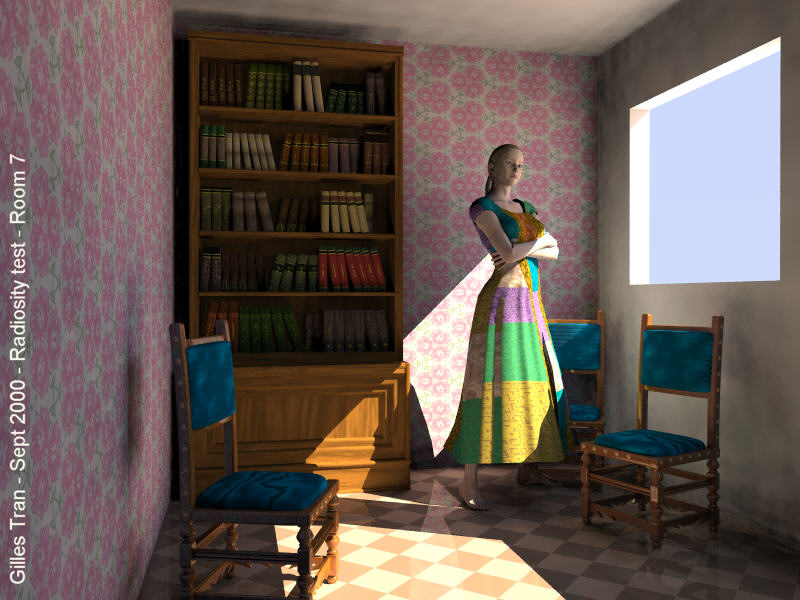

Disclaimer : this scene has no artistical merit whatsoever. It's ugly,
but it's just a test for a radiosity setup that could be acceptable for
a "real" interior scene.
It uses some of the recently gained radiosity knowledge posted in this
group (Arnold settings and outdoors lighting particularly). There's only
one light source, coming from the window. Everything else is indirect
lighting. Balancing the light was difficult. I ended up raising the
brightness to 2 and lowering the Kari Kivisalo light intensity.
Assumed_gamma is 1. It took 4 hours to render on a PIII 733 at 800*600
aa 0.3.
Some of the radiosity effects are really OK. Vicky's face is nicely lit,
and there's even a backlit effect on her right arm. The shadow of the
chair on the left seems good too. On the bad side, there are quite a
number of radiosity artifacts visible on the right wall and on Vicky's
face and right foot (note : raising the recursion level to 2 had
appalling effects on Vicky so I left it to 1). Also, I had to add
reflection to the chairs to make them look better, which lets me think
that one last thing to improve in Megapov radiosity is it's ability to
react like a regular light with some of  the texture properties
(highlights). I didn't try to "cheat" with light groups or area lights
to fix that, though I'll do it probably on a real pic.
Credits : Victoria is the hi-detail Poser girl from Zygote (dress by
Catherine Todd). The chairs and the library are available on my website
(when it works). The wallpaper is just terrible.
The whole scene (but big Vicky who weights around 15 Mb) is posted on
p.b.s-f.
G.

From: ryan constantine
Subject: Re: Radiosity - interior scene test (90 kbu)
Date: 12 Sep 2000 15:42:14
Message: <39BE871A.B3808900@yahoo.com>
i'm not worthy

From: Gilles Tran
Date: 12 Sep 2000 15:53:32
Message: <39BE8937.6485AAA8@inapg.inra.fr>
ryan constantine wrote:
> i'm not worthy
Come on, it's just a box with a hole in it for the light to shine in, radiosity
settings found in this NG, plus some objects I had made before and a mesh I
bought. No big deal. The only thing I did made here is the checkered plane and
the fine tuning.
G.
Date: 12 Sep 2000 16:06:11
Message: <39BE8CF2.87195D4F@schunter.etc.tu-bs.de>
The lighting of the paper walls looks very pleasant, while the other walls seem
to have much artefacts.  I wondered about brightness 2 - i always thought it
should stay near 1. Have you tried brightness 1 and recursion_limit 2 ?
The reflective floor with no visible light reflections on the walls is somewhat
irritating.
Most other things look extremely good, esp. the chairs (reflectivity works good
on them), but using these high end radiosity settings in a more complex scene
will probably be real pain :-)
From: Gilles Tran
Date: 12 Sep 2000 16:21:59
Message: <39BE8FE3.CEA94976@inapg.inra.fr>
Yes. In fact, the lighting setup requires a limit of 2 (at least in Kari Kivisalo
setup). The trouble is that using a limit of 2 I had a terrible answer from the
character mesh (very ugly artifacts), not to mention the exploding render time.
> irritating.
Photons would certainly be appreciated. Not sure about the render time though. I
also tried a version with media... Cough, cough.
That's precisely what I want to know. Right now it's quite acceptable and much
better than any radiosity I've done with Povray, but there's still a lot to test.
Arnold-like things are very nice but if I can't replicate some of the effects in a
real scene with a render time compatible with my lifespan I'll be very
disappointed. Note that at the same time, a complex scene could be more tolerant to
radiosity artifacts so there's hope.
G.

From: Josh English
Date: 12 Sep 2000 16:30:19
Message: <39BE9238.42962287@spiritone.com>
Wow. Gilles Tran admits to "no artistical merit" and still produces an amazing
image.
The pink bar in the sky is a little odd though, and the lights are a bit dark,
the floor, I think, should have more light on it in general, because there is
too much shadow.
Josh
Date: 12 Sep 2000 17:18:00
Message: <39BE9DC5.261C3B4D@schunter.etc.tu-bs.de>
That's probably true.
I just started a try myself, but can't judge for the mesh of course.
There are sometimes things that require waiting for a faster computer :-) Doing
this scene with media would definitely be interesting.  I did not use photons
very often but they would also be useful when adding a glass pane to the window.
There doesn't seem to be anything we can do about the artifacts. I think
it's a flaw in the current algorithm, it's not optimised for really low
error_bound, and there's no way around it except rewriting the code.
Whoever wrote it (Nathan?) would know more about that than I would, though.
The only thing I can think of is to turn the count WAY up, use a tiny,
tiny pretrace_end (values lower than 0.01 seem to be valid on large
images, so you could give that a shot), and maybe increase some other
thing to 20 (I can't remember what it was off the top of my head,
probably was nearest_count.. but whatever it is, it maxes out at 20, so
you can check the dox for it). I doubt that'll get rid of the artifacts,
but it might smooth them a little more.
The artifacts aren't all that noticible to begin with, though. You could
probably ignore them altogether unless they really make your scene look bad.
It might be safe to add photons to the floor; I haven't done extensive
testing, but they didn't have a dramatic effect on my bonsai tree render
(the shiny part of the table thingy had photons). Come to think of it,
they didn't have a dramatic effect on the output either, but.. eh, whatever.
You might add some texture to the plain wall and the ceiling; not only
would it look a little more interesting, but it would probably break up
the artifacting on the right wall.
The wallpaper IS hideous.
The window could use some glass, or something.
The bookcase could probably benefit from a slight application of that
"fake highlight" reflectivity, and the floor might look better if it was
a little more reflective, and blurry.
Some media would be nice too.
Oh, and you could buy a second computer to use while the first one
renders this thing with media, photons, a ridiculously high radiosity
count, isosurfaces and/or normal_on (for the wall and ceiling textures),
and reflection blur... ^^;;
