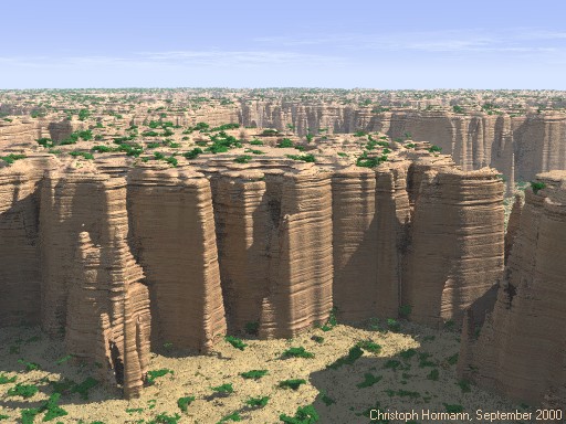

I think i will stop working on this scene for the moment, here is the last
rendering i made.  I became much too slow for easy modifications, this picture
took about 27 hours to render.
Some more stats about the picture:
2 objects (isosurface and sky)
Calls to Noise:        6396741740
Calls to DNoise:       12837190298
Peak memory used:      13429632 bytes (mostly used for radiosity)
isosurface accuracy:   0.003
Including the plants in the same isosurface is really difficult, because they
tend to float in the air not having contact to the ground (you can see it in the
picture at several positions).
Maybe i can try to make a larger version when i'm going on vacation sometime,
but right now i'm really fed up with waiting days for such a tiny picture to
finish :-)
NTL, comments are still welcome.

That does seem an awful long time for this.  Surprised to see the memory
goes that high too.
What are the plants made from?  And I don't think I would have noticed some
were floating unless you had said.
I'd bet it's the distant part which is so slow anyway.  Maybe you could opt
for a different angle, such as from lower down and looking through a
crevasse instead.
> goes that high too.
Most of the memory is needed for radiosity (without it's less than 1 Mb)
Some definitely are (just look after the shadows).  They are made from a highly
turbulent quilted pattern.
> crevasse instead.
You are right about the distant part, the first lines of the terrain rendered at
about 4-5 seconds per pixel.  A change of the viewpoint could be worth trying
although it would still be quite slow.

Bummer it takes so long.  It looks really good, though.  I guess
an animated fly-thru is out of the question!

That's impressive stuff.  The plants don't look bad at all, although maybe
they could be scaled a bit smaller? Anyway maybe that macro that determines
the height at a particular point could be applied to the plants to make
them not float.  (HF_Height_At or something?  I've never used it).  Maybe
it'd just add hours to the render.  Still, it's a shame it takes so long
that it will never be given the full treatment.  I've never seen any
attempt at desert mesas come so close to looking realistic.  Find a friend
with a huge, expensive computer.
Placing the single plants individually would be a solution, but it would need a
lot of memory placing them all the way to the horizon (that would be at least
several thousand objects)

Not bad! Not quite "photorealistic", but a cool work of art.
> finish :-)
lol

I tend to overlook stats quite a bit so I checked them for myself and I
hadn't realized before that radiosity  uses the memory chips so intensively,
I thought it was primarily a CPU thing.  Guess memory is a part of doing
that now that I think about it.

Wow this is looking good, but it needs some randomness in the shade of green
of the plants, and they do look asthough they're flying away in the wind.
I don't mind doing renders for days on end, so if you want you're welcome
to send me the scene files and I'll render it for you, but it'll take
more than a day or two as I'd have it run in the background along with
all the other stuff that I have running from time to time.
Thanks, as i said, some of them are really flying, they are just a quick try,
coloring is not optimized at all.
Thanks for the offer, but the problem is not so much the occupation of the
computer but my patience :-)
