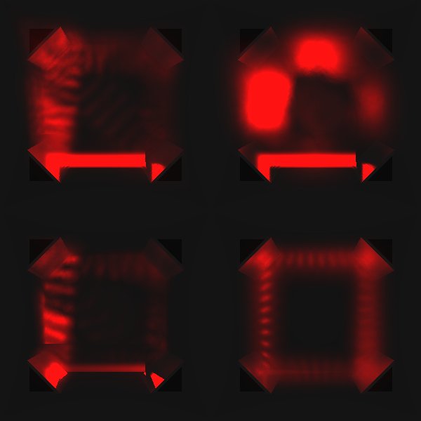

A little more fun with reflected light in media stuff.
Basically, changes to the intervals and samples in the media itself makes
the most change.  I liked the interference wave pattern type thing.  Even
the top left render was showing a diagonal reflection across to each other,
very faint.  Notice that although the cylinder type spotlight was used, for
all but the lower right render, they all reflect like a regular spotlight.
Not good a scene so I won't post anymore of this "test" material here  :-)

Subject: Re: reflecting photons in media testing 2 [~27KB Jpg]
Date: 17 Aug 2000 12:05:19
Message: <399C0D59.17FB6CDD@schunter.etc.tu-bs.de>
All that looks very interesting even though i have not much idea about it.  I
suppose those stripes are no real interferences, right :-)
BTW, how long do such scenes take to render ?
Date: 17 Aug 2000 13:50:38
Message: <399c25ee@news.povray.org>
"Christoph Hormann" <Chr### [at] schunteretctu-bsde> wrote in
message news:399C0D59.17FB6CDD@schunter.etc.tu-bs.de...
I
The striping is probably from the spiral pattern photons are mapped out
from, that's my guestimation.
Not very long really.  About 3 minutes on this 500MHz machine for those 300
by 300 pixel renders, and that includes photon calculating.
So far I've seen that it's closer to 5 minutes, or more, if better settings
are used.  But not slow at all.  Dare I say fast.
