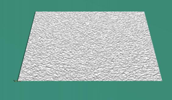

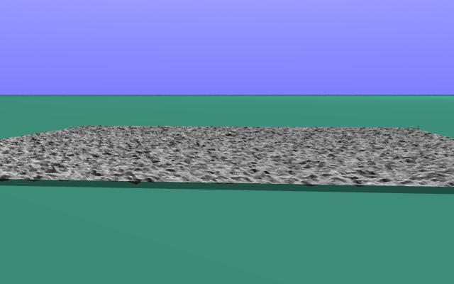

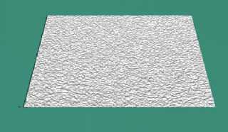

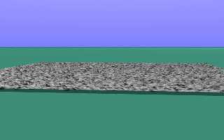

I took an interest in exploring order in chaos from a different
direction. I was inspired by a suggestion in a research report
that in the long run (enough iterations) clearly non-random
results appear. This first approach was simply getting the
process to work. There was no methodology in the report.
Using the attachment as an example --
	It starts with an array 0..257 by 0..257 with all the pairs
containing 0 and 257 (the edges, boundary values) constrained to
zero.
Step 1. Each of the other array elements, 1..128,1..128 are given
a random number between -0.5 and +0.5.
Step 2. Then each cell is averaged with its nearest neighbors (8
neighbors + itself for 9).
Step 3. Return to step 1, twenty times in the case of the
attached image.
Step 4. convert the final array of numbers into triangles in mesh
object format.
Setp 5. Render
	It's a 19Meg POV source file if anyone is realy desperate. The
generating program is only 2k but you have to have Turbo Pascal
or download Free Pascal. (Go to Google.com and search 'free
pascal'. There are plenty places to get it.) Of course it is a
first attempt
	All that aside, speaking of the image, the scale is linear, that
is 258 units on a side with the added increments of +/- 0.5 at
each step. Visually I see some extended patterns in the image. It
is also visually interesting but then so are the holes in
acoustic ceilings if you have nothing better to do with your
time.
	Eventually I intend to produce an animation of this, one frame
per iteration (step 3).
	/*Ignore the little thing in the lower left corner. I just
dropped the mesh into an existing scene file.*/
Kareoke is Japanese for tone deaf.
    -- The Iron Webmaster, 15
Download 'array2.jpg' (27 KB) Download 'array2a.jpg' (21 KB)
Preview of image 'array2.jpg'
Preview of image 'array2a.jpg'

	I can say this now that I have run it a few times and more
iterations. As it is a real number +/- 0.5, I have yet to find a
number that is +/- 10.0 or greater. Lots of +/- 9.xxx's. That
indicates a valid random number generator to me while I consider
the 256x256 a test of calling it.
	Something I did not mention, I have to kill apps and 'sync' else
povray complains that it has run out of RAM at 128M of same.
	That said, I don't quite see what you are saying.
	But I could do the pigment {color calculated} and dark to light
blue between -10 and +10 to make a shot at waves.

From: Greg M  Johnson
Subject: Re: concept to visualization
Date: 23 Aug 2000 11:27:41
Message: <39A3EC3C.22F9DE8A@my-dejanews.com>
Matt's approach is probably brilliant for other fractal problems, but methinks
this is really a duplication of one of the noise functions.  An isosurface scene
file with 19 lines, instead of 19 MB,  could do the same thing, no?
