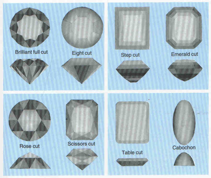

Subject: Re: Diamond cuts
Date: 18 Aug 2000 19:34:05
Message: <399DC5BB.42151A99@faricy.net>
Sorry, forgot to check descreening...
Brilliant full cut - at least 32 cuts plus table on top, at least 24 on
bottom
David Fontaine   <dav### [at] faricynet>   ICQ 55354965
Please visit my website:  http://davidf.faricy.net/
Download 'cuts.jpg' (44 KB)
Preview of image 'cuts.jpg'
