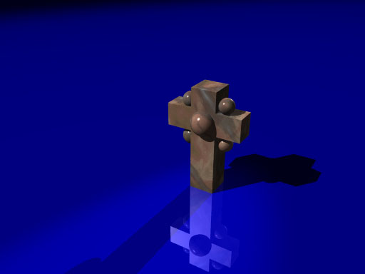

Hi all,
            here is the result of my second project. I'm very pleased with
this, especially as it is very close to the picture I had in my mind.
   I still do not understand anti-aliasing, although it was rendered at
512x384 AA 0.3. Can anyone enlighten me as to getting it better?
   Hope you like it.
           ~Steve~
Download 'New File copy.JPG' (15 KB)
Preview of image 'New File copy.JPG'

The cross could need some normal (looks very clean and shiny right now, just
like plastic :-)
I would also suggest some different environment, the reflective plane looks
interesting, but it does not really fit to the object IMO. I could think of a
coffin, an altar, a graveyard (with more crosses in variations), ...

Anti-aliasing is a system for reducing "jaggies" If there are adjacent
pixels which would normally contrast with each other, AA will sortof average
the color values of the surrounding pixels with the pixel being plotted and
lessen the contrast making the "jaggies" blend and soften. Makes sharp lines
a bit blurry, oddly enough the effect is that the images may look sharper
and less computerized.
I am quite horrible at explaining concepts like this. I hope that that was
intelligeble.
BTW: looks like your starting to get the hang of it :)

        Hi Halbert,
                           I understand every word, Halbert. You have
described it well. The thing that I don't understand, however, is what you
actually do? On the help pages it says that you type in  +a, and other
things, but 'where' do you type these commands? Or is it a command 'off
screen', I hope that you understand what I am trying to say.
      If it is 'on screen', then where in your 'recipe/formula', (is there
another word?), do you put it? At the beginning? At the end? I'm sorry for
asking this, but I am at a loss as to what to do, even after reading through
the help pages.
    I'm glad that you liked it Halbert. Getting that last sphere, (the one
on the bottom left as you look at it), was a nightmare!!  My stomach was
'buttering with flutterby's' when I finally did the last render 'knowing' it
was going to be in place, or was it? ;o)   50/50 with me at the moment!
         Thanks, ~Steve~

It is an ini-file or command line option. You can:
Add an entry or edit an entry in QUICKRES.INI, which is where the options in the
pull-down list come from:
[Entry title]
Width=n
Height=n
Antialias=On
Antialias_Threshold=n
Specify command-line options in the Edit Settings/Render window under the Render
menu:
+Hn +Wn +An.n
Create a new INI file and parse it:
Width=n
Height=n
Antialias=On
Input_File_Name=filename.pov

Thanks David,  thats great! I'll be able to have a play around with it
now! I was really pleased with this image, and then you get to see the
'jaggies'! So, I  am glad that there is a part of this programme that can
help with this.
    Thanks for your help.    ~Steve~

The information is kind of scattered around if you RTFM, so I thought it'd be
better to post an example. For the longest time I was creating INI files with
the same filename as the scene and they weren't doing anything, it took me
forever to figure out you have to parse the INI!! Oh well.
If you want a full explanation of AA types and settings, read the secton
"Anti-Aliasing Options" in the docs.

Great looking image, but it's shouting "Give Me Some AREA LIGHTS".
From the POV documentation:
4.5.5.4   Area Lights
Area light sources occupy a finite, one- or two-dimensional area
of space. They can cast soft shadows because an object can
partially block their light.  Point sources are either totally
blocked or not blocked.  <End of quote>
Area lights slow rendering down considerably, thought I'd warn you.
The doc goes on to explain the syntax etc of area lights,  there's
also good stuff in there on AA and probably anything that you'd want
to know, there's no harm in asking here aswell as some of our regular
visitors/participants have developed knowledge that goes beyond the docs.

(Unlike when you write with a plotter, for example.)
When you use the +axx.xx option, you turn on antialiasing. The float after
+a is the tolerance of the AA. Lower, the less tolerant. A value of 0.1 will
cause povray to trigger the AA-method for the pixel in question if the pixel
differ with 10% in colour from one of it's neighbours (to the top and left.)
A higher value will cause Povray to be more nonchalant, that is it lets
bigger differences pass.
The AA method actually shoots another ray; i.e. sample, into the scene
_between_ the two differing pixels. The resulting pixels (both the current
and the previous which differed) are then recalculated with the extra
information provided from the second sample. In that way, the image gets
smoother.
There is also an alternate method of AA; the adaptive. (Am I right here?)
Set the +am2 option, the usual +axx.xx and an additional option +rn, where n
is the recursion level. Povray will now; when it encounters two differing
pixels as before, shoot a new ray as before. But it doesn't stop here! It
does so n times, so that even the in-between "pixel" is re-sampled; giving
an even smoother image as result! Alas, the price is rendering time. Try to
model a refractive sphere over a checkered plane. If the ior is about 1.4,
you should see a "warped" version of the plane in the sphere, and it gets
typically _very_ aliased (that is you get interference patterns in the
sphere.) This effect is also visible in the horizon; where the plane meets
the sky. (!). Now, turn on antialiasing with +a0.0, +am2, +r4 and see what
happens to the render time...
In my experience, a depth (+r) higher than 2 gives almost no difference in
apperance. For high quality renders, I use +a0.1 +am2 +r3 as options. This
gives very nice results, but don't do it on test renders when you have a lot
of reflection and refraction going on in the scene!
This should be _failry_ accurate information; arrest me if I'm wrong on
something! (It's late in the evening too...) This was fun. :)
- Simen Kvaal. (wannabe antialiasing expert...)
