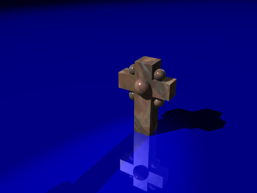

Hi all,
            here is the result of my second project. I'm very pleased with
this, especially as it is very close to the picture I had in my mind.
   I still do not understand anti-aliasing, although it was rendered at
512x384 AA 0.3. Can anyone enlighten me as to getting it better?
   Hope you like it.
           ~Steve~
Download 'New File copy.JPG' (15 KB)
Preview of image 'New File copy.JPG'

25ct wrote:
>    Hi all,
>    Hope you like it.
The cross could need some normal (looks very clean and shiny right now, just
like plastic :-)
I would also suggest some different environment, the reflective plane looks
interesting, but it does not really fit to the object IMO. I could think of a
coffin, an altar, a graveyard (with more crosses in variations), ...

"Christoph Hormann" <Chr### [at] schunteretctu-bsde> wrote in
message news:39995391.F59B1975@schunter.etc.tu-bs.de...
> 25ct wrote:
> >    Hi all,
with
> >    Hope you like it.
just
> like plastic :-)
looks
of a
> Christoph
> Homepage: http://www.schunter.etc.tu-bs.de/~chris/
     Thanks Christoph,  I'll work on it. ;o)

On Tue, 15 Aug 2000 15:11:02 +0100, 25ct wrote:
>   Hi all,
Great looking image, but it's shouting "Give Me Some AREA LIGHTS".
From the POV documentation:
4.5.5.4   Area Lights
Area light sources occupy a finite, one- or two-dimensional area
of space. They can cast soft shadows because an object can
partially block their light.  Point sources are either totally
blocked or not blocked.  <End of quote>
Area lights slow rendering down considerably, thought I'd warn you.
The doc goes on to explain the syntax etc of area lights,  there's
also good stuff in there on AA and probably anything that you'd want
to know, there's no harm in asking here aswell as some of our regular
visitors/participants have developed knowledge that goes beyond the docs.

(Unlike when you write with a plotter, for example.)
When you use the +axx.xx option, you turn on antialiasing. The float after
+a is the tolerance of the AA. Lower, the less tolerant. A value of 0.1 will
cause povray to trigger the AA-method for the pixel in question if the pixel
differ with 10% in colour from one of it's neighbours (to the top and left.)
A higher value will cause Povray to be more nonchalant, that is it lets
bigger differences pass.
The AA method actually shoots another ray; i.e. sample, into the scene
_between_ the two differing pixels. The resulting pixels (both the current
and the previous which differed) are then recalculated with the extra
information provided from the second sample. In that way, the image gets
smoother.
There is also an alternate method of AA; the adaptive. (Am I right here?)
Set the +am2 option, the usual +axx.xx and an additional option +rn, where n
is the recursion level. Povray will now; when it encounters two differing
pixels as before, shoot a new ray as before. But it doesn't stop here! It
does so n times, so that even the in-between "pixel" is re-sampled; giving
an even smoother image as result! Alas, the price is rendering time. Try to
model a refractive sphere over a checkered plane. If the ior is about 1.4,
you should see a "warped" version of the plane in the sphere, and it gets
typically _very_ aliased (that is you get interference patterns in the
sphere.) This effect is also visible in the horizon; where the plane meets
the sky. (!). Now, turn on antialiasing with +a0.0, +am2, +r4 and see what
happens to the render time...
In my experience, a depth (+r) higher than 2 gives almost no difference in
apperance. For high quality renders, I use +a0.1 +am2 +r3 as options. This
gives very nice results, but don't do it on test renders when you have a lot
of reflection and refraction going on in the scene!
This should be _failry_ accurate information; arrest me if I'm wrong on
something! (It's late in the evening too...) This was fun. :)
- Simen Kvaal. (wannabe antialiasing expert...)
