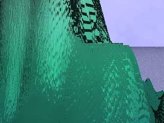

I remember having seen a message regarding this problems already, but
can't seem to find it.
Just look at the image - why can't a make a smooth HF?!!
Download 'nland.jpg' (25 KB)
Preview of image 'nland.jpg'
From: Lewis
Subject: Re: HF problems
Date: 15 Aug 2000 08:14:31
Message: <39994125.E90EA96B@ss.com>
BTW the resolution is not the problem - it's 2000 * 2000...

From: Kari Kivisalo
Date: 15 Aug 2000 08:29:56
Message: <399937DA.8851B5F9@kivisalo.net>
This must be 8bit hf, try 16bit tga.

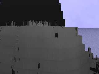

From: Lewis
Subject: NEW HF problems
Date: 15 Aug 2000 09:24:03
Message: <39995164.8BA17532@ss.com>
Thanks, it works.
However, I still can't understand what's the problem with MY source.
Further more, this is what comes out when I try to use that output in
the HF scene:
Download 'nland.jpg' (10 KB)
