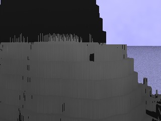

I remember having seen a message regarding this problems already, but
can't seem to find it.
Just look at the image - why can't a make a smooth HF?!!
Download 'nland.jpg' (25 KB)
Preview of image 'nland.jpg'

BTW the resolution is not the problem - it's 2000 * 2000...
This must be 8bit hf, try 16bit tga.

I am having trouble creating the HF as a 16-bit grayscale. It has 256
colors (8 bits) but I can't get more for some reason. How do I ??

"Lewis" <tt### [at] sscom> wrote in message news:39994891.DAC8B978@ss.com...
Since you have a 24 bit targa there the thing to do probably is to use it as
a pigment {image_map{}} and do a global_settings {hf_grey_16 on} to get it's
16 bit greyscale.  Only problem might be if it's not already a greyscale
image the conversion of the colors just might go wrong for what you have
intended, but I'm not sure of that.
Anyway, if you're willing to go that route then just use a orthogonal camera
with the same up and right as the image resolution, mapping to a plane of
course.  Also set the file output type to +FT so you don't get a BMP or
something.

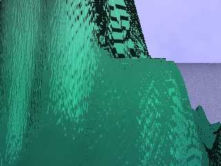

From: Lewis
Subject: NEW HF problems
Date: 15 Aug 2000 09:24:03
Message: <39995164.8BA17532@ss.com>
Thanks, it works.
However, I still can't understand what's the problem with MY source.
Further more, this is what comes out when I try to use that output in
the HF scene:
Download 'nland.jpg' (10 KB)
