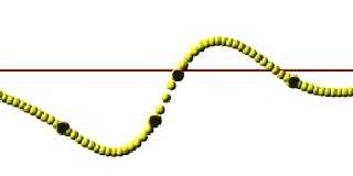

I want a smoothly varying function that goes between the following
points:
    <0.00, -15>,
    <0.25, -125>,
    <0.45, -110>,
    <0.50, -10>,
    <0.75, -25>,
    <1.00, -15>
The function/ spline will serve as a keyframing notation for the joints
in a body, ala < timei , thetai >. Such that if I call out 0.375 for the
x, I should get something not too far from 117.
My own "cosinespline" is inadequate (see 04/14/00 posting) :  not much
better than straight lines.  Chris Colefax's macro has a ton of options
which offer some promise, but it is woefully lacking an adequate
explanation of what he dreamed up. I'm suspecting it cannot even handle
an irregular list like above.
Can anyone help me?
Download 'cossplinevscubic.jpg' (27 KB)
Preview of image 'cossplinevscubic.jpg'

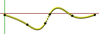

From: Libellule
Subject: Cubic spline mentioned above 18kbbu
Date: 11 Aug 2000 00:25:02
Message: <3993804F.36A34A26@insectes.net>
Using the data in the original post
(Solved externally)
Data points shown with slightly larger spheres than the rest
Download 'cubicspline.jpg' (18 KB)
Preview of image 'cubicspline.jpg'
From: Greg M  Johnson
Subject: Re: Cubic spline mentioned above 18kbbu
Date: 11 Aug 2000 09:23:50
Message: <3993FD39.52D9976@my-dejanews.com>
This is actually supposed to be the rotation of a knee across a walk cycle. In
your solution, which is very similar to mine, the knee would be bending
backwards (theta>>0) during part of the cycle.  If you look at my solution in
the blue curve that I posted, it is devoid of the above error, but so flat it
is not much  better than straight lines.
> (Solved externally)

I think the green and/or red curves are typical of what one sees with the mega
splines.
I think Colefax's spline has lots of neat knobs & levers, but no explanation
in the available tuts.
