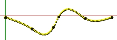

I want a smoothly varying function that goes between the following
points:
    <0.00, -15>,
    <0.25, -125>,
    <0.45, -110>,
    <0.50, -10>,
    <0.75, -25>,
    <1.00, -15>
The function/ spline will serve as a keyframing notation for the joints
in a body, ala < timei , thetai >. Such that if I call out 0.375 for the
x, I should get something not too far from 117.
My own "cosinespline" is inadequate (see 04/14/00 posting) :  not much
better than straight lines.  Chris Colefax's macro has a ton of options
which offer some promise, but it is woefully lacking an adequate
explanation of what he dreamed up. I'm suspecting it cannot even handle
an irregular list like above.
Can anyone help me?
Download 'cossplinevscubic.jpg' (27 KB)
Preview of image 'cossplinevscubic.jpg'

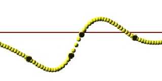

From: Libellule
Subject: Cubic spline mentioned above 18kbbu
Date: 11 Aug 2000 00:25:02
Message: <3993804F.36A34A26@insectes.net>
Using the data in the original post
(Solved externally)
Data points shown with slightly larger spheres than the rest
Download 'cubicspline.jpg' (18 KB)
Preview of image 'cubicspline.jpg'
From: Greg M  Johnson
Subject: Re: Cubic spline mentioned above 18kbbu
Date: 11 Aug 2000 09:23:50
Message: <3993FD39.52D9976@my-dejanews.com>
This is actually supposed to be the rotation of a knee across a walk cycle. In
your solution, which is very similar to mine, the knee would be bending
backwards (theta>>0) during part of the cycle.  If you look at my solution in
the blue curve that I posted, it is devoid of the above error, but so flat it
is not much  better than straight lines.
> (Solved externally)
Subject: Re: Is there a spline solution out there?
Date: 11 Aug 2000 09:28:15
Message: <3993FE3D.6C69C2D@my-dejanews.com>
I think the green and/or red curves are typical of what one sees with the mega
splines.
I think Colefax's spline has lots of neat knobs & levers, but no explanation
in the available tuts.

From: Libellule
Date: 11 Aug 2000 09:57:44
Message: <39940692.38F86AEA@insectes.net>
Oh well, I tried :)

you can control how much it bends (and how smooth the curve is) with
tension
you can control which end of a segment the maximum bend is near with
bias.
Incidentally, the cubic interpolation (cerp) and Horner's method
(horn) macros can create many other spline types with an appropriate
control matrix.  You should be able to figure out the rest from here.
If not email and I will send you a full demo as health permits.
This expects your control points to be in the array Points and  Bias
and Tens to be (0 to 1) variables already declared.  The other
variables are either obvious or irrelevant material from the original
project.
// begin partial code snippet
#macro Mxv(In, Mx)
  <max(In.x, Mx.x), max(In.y, Mx.y), max(In.z, Mx.z)>
#end
#macro Mnv(In, Mn)
  <min(In.x, Mn.x), min(In.y, Mn.y), min(In.z, Mn.z)>
#end
#declare Tau = array[4][4]
    { (Bias - 1) * Tens, 2 - Bias * Tens, (1 - Bias) * Tens - 2, Bias
* Tens },
    { 2 * (1 - Bias) * Tens, (3 * Bias - 1) * Tens - 3, 3 - Tens,
-Bias * Tens },
    { (Bias - 1) * Tens, (1 - 2 * Bias) * Tens, Bias * Tens, 0 },
    { 0, 1, 0, 0 }
#macro Horn(Row, Pt)
  (T * ( T * (T * Tau[0][Row] + Tau[1][Row]) + Tau[2][Row]) +
Tau[3][Row]) * Pt
#end
#macro Cerp(Pf)
  Horn(0, Points[Pf - 1]) + Horn(1, Points[Pf]) +
  Horn(2, Points[Pf + 1]) + Horn(3, Points[Pf + 2])
#end
union
    #declare Iter = 1;
    #while(Iter < Dim + 2 * Close)
      #declare Count = max(1, int(Fine * vlength(Points[Iter + 1] -
Points[Iter])));
      #declare Incr = 1 / Count;
      #declare T = 0;
      #while(T < 1)
        #declare Start = Mxv(Mnv(Cerp(Iter), <24 * Aspect, 24, 24>),
                         <-24 * Aspect, -24, 0>);
        #declare T = T + Incr;
        #declare End = Mxv(Mnv(Cerp(Iter), <24 * Aspect, 24, 24>),
        #declare End = ((End.x = Start.x) ? End + <.001, 0, 0> : End);
        sphere { Start, Width }
        cylinder { Start, End, Width }
      #end
    #end
// end partial code snippet
Jerry Anning
clem "at" dhol "dot" org
