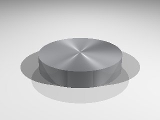

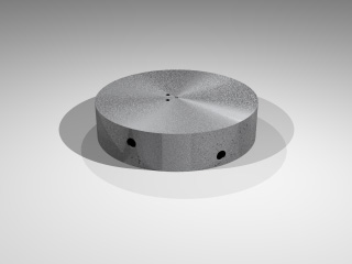

Attached is a jpg of part of a simple scene I am doing that involves
metal textures. At present, the render is taking _far_ too long, because
to avoid aliasing errors, I've had to use sampling method 2 at a depth
of 5. The texture is as follows...
texture
        pigment
                colour rgb <0.72,0.728,0.744>
        normal
                spiral1
                1
                frequency 25
                bump_size 0.33
                accuracy 0.0008
                rotate <90,0,0>
        finish
                ambient 0.05
                diffuse 0.95
                specular 0.96
                roughness 0.0005
                phong 0.43
                phong_size 25
                brilliance 3.15
                reflection 0.33
                reflect_metallic
                metallic on
Is there a quicker way to achieve similar results, specifically, with
the normal to get the spiralling effect?
MJL

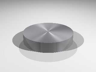

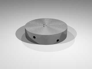

Thanks Rune. I thought of using wood or onion, but the good thing about spiral
is that in addition to giving the nice radial pattern on the face of the metal
cylinder, it _also_ gives fine grooves along the length of the metal cylinder.
Have a look at machined metal cylinders and you'll notice them. They are
responsible for some nice highlights along the length of a metal cylinder, and
using spiral, POV can simulate these to a much greater extent than wood (I don't
know about onion, but I might place a bet on "probably not").  I've attached two
pics of the different effects. The tex is the same as I posted before for
spiral, and wood is very similar (replace spiral1 with wood, and up the
frequency a bit (~*1.25) to get a similar pattern). Note the different effects
on the length of the cylinder, and the way AA depth of 3 (chosen for speed) adds
alot of artefacts.
Could you please give a quick example of the averaging of normals method? I
don't quite follow.
MJL

I have to agree. Particularly the left texture looks great! I fear that
a faster technique would worsen it.

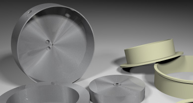

I had forgot some details about my method - it's a bit more complicated. You
average whole textures instead.
The attached image was rendered without AA at all, and it took 25 seconds to
render. The effect is a bit different than yours, but it might work for you
with some modifications.
If you're still interested, I can post the code of you like.

Yeah, some sample code would be great, if it's not too much trouble.
As a time comparison, my two images each took ~ 3 mins on a P233.
MJL
> > | of 5.
> > But it looks so good as it is.
> > There's my 2 cents on it, sorry if no help.
> I'm sorry, too.
> Thomas
> http://www.thomas.willhalm.de/ (includes pgp key)

Mark James Lewin <m_j### [at] yahoocomau> writes:
> Thanks Bob and Thomas for your comments. I'm sure both of you wouldn't like
> the tex so much if you had to render it though! AA depth of 5 is an absolute
> nightmare.
Well, 3 minutes isn't so incredibly long. The scene I'm working on takes
4 hours to render if I include all objects and textures...
On the other hand, Rune proved me to be wrong. If it is possible to reduce
the render time to one sixth without loosing quality, this helps a lot
while developing your scene.
