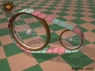

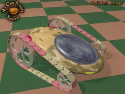

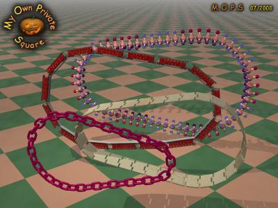

Here is a second macro i have made.
It build a belt between two wheels ( so i named it "buildbelt" )
and it could make it roll ( i will post two animations for example at
p.b.a )
Note : the macros are in "mopspatch.inc" ( see
http://perso.wanadoo.fr/mops/atelier.htm )
and feel free to use, rewrite and improve them, there is no copyrigth !
The syntax is like :
#declare belt_R1=3;    /* radius of the first wheel, his center is O
#declare belt_R2=5;    /* the second one
#declare belt_d=10;    /* distance between the two wheels
#declare belt_nb=30;    /* number of elements
#declare belt_tour=-1;    /* number of revolution when clock go from 0 to 1
#declare belt_typ=2;    /* if 1 belt_tour is the number of revolution of the
wheel
                                    /*if 2 belt_tour is the number of
revolution of the belt
#declare belt_norm=y; /* for the orientation of the elements
/* definition of the elements :
#declare k=1;
#while (k<belt_nb+1)
                               #declare
belt_el[k]=object{maillon(Steel,Alu4)
                                                    scale <1,2,1
>material{ecran}}
  /* maillon is an object created in my mopspatch.inc, it is an example
#declare k=k+1;
#end
object { buildbelt(clock) }
it give back four variables :
belt_al :  belt angle ( usefull to put the belt on a floor )
belt_Long : belt length
belt_Dl=  length of one element
belt_R1bis  : to calculate the visible radius of the wheel
belt_R2bis
Hope i am understable,
My Own Private Square.

From: J  Grimbert
Subject: Re: Need a belt ?
Date: 7 Aug 2000 09:44:21
Message: <398EBD3E.AE9AE8D7@atos-group.com>
> p.b.a )
Well, interesting. But I'm nitpicking (probably too much, so
do not bother...)
The belt are fine for modeling infinite tension, but in
reality, usually, one of the 'line' between the wheels is not
straight: it is curved, due to the gravity and the lesser
tension between the motored wheel and the motor wheel.
It may even happen on loose belt, that both 'line's are curved
when not moving, and the direction of the movement, as well
as the driving wheel will decide which line go straight at
move time.
What about adding a third wheel (outside the belt), to adjust
the tension ? or a more complex thing like the bicycle one ?
Yes, I'm not sure I was.
P.S: Great work anyway!
