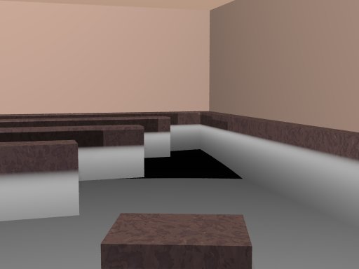

I was trying to get a fog-like effect with media, unfortunatly
I got the following picture. I thought initially that there was a non-hollow
object interfearing with the media, fog type 2 (ground fog) works fine.
The media container is definatly hollow.
The second picture is the same scene using fog type 2. That is what I want
to get with media
I've been fighting with this for two weeks now and I'm out of
ideas. I've posted the source for the simplified scene in p.b.s-f
If anyone can tell me what the problem is, I will be very grateful.
(Bill I have a feeling I'll need one of your signs)
Thanks
Gail
Your problem lies in trying to get absorption, emission and scattering all
in the same media statement. You need to declare each media type separately
within the interior statement. I've listed out below how to get it to work.
BTW, having all three really slows things down. I'd use emission for test
purposes and then try different combinations of the three to get a final
effect.

Using emission, absorption and scattering in a single media statement
is perfectly legal. However, they will share the same density which
will render them rather useless (unless the density is totally
unsaturated, color-wise).
Only true a) for scattering and b) for separate media statements.
Peter Popov ICQ : 15002700
Looks like there're too few samples. Try starting with 5 or 10 and
then use anti-aliasing along the way.

Peter Popov wrote in message <961josgklq8m3mv5ahg1qqaut1aqubdno1@4ax.com>...
>On Thu, 3 Aug 2000 09:57:33 +0200, "Gail Shaw" <gsh### [at] monotixcoza>
I feel really dumb now.
<rereads mega documentation> Mega creates extra intervals not
extra samples.
I had an odd idea that only one sample was needed and more would be created
as necessary.
Thanks for the help Peter. Pic looks a lot better now.
Gail

I would let you have my sign but I need it as I've made the same
mistake a couple of weeks ago. It was more obvious in my case, though.
>as necessary.
That's how antialiasing works. However, in order to be able to get a
sample in-between two others, MegaPOV will need, well, at least two
others :)
