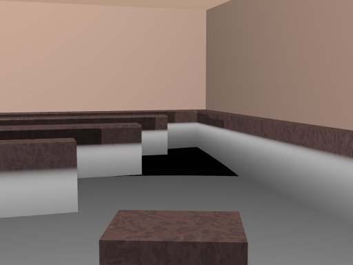

I was trying to get a fog-like effect with media, unfortunatly
I got the following picture. I thought initially that there was a non-hollow
object interfearing with the media, fog type 2 (ground fog) works fine.
The media container is definatly hollow.

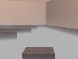

The second picture is the same scene using fog type 2. That is what I want
to get with media

>If anyone can tell me what the problem is, I will be very grateful.
Looks like there're too few samples. Try starting with 5 or 10 and
then use anti-aliasing along the way.
Peter Popov ICQ : 15002700
From: Gail Shaw
Subject: Re: Strange media effect. (20kbu)
Date: 4 Aug 2000 03:16:23
Message: <398a6dc7@news.povray.org>
Peter Popov wrote in message <961josgklq8m3mv5ahg1qqaut1aqubdno1@4ax.com>...
>On Thu, 3 Aug 2000 09:57:33 +0200, "Gail Shaw" <gsh### [at] monotixcoza>

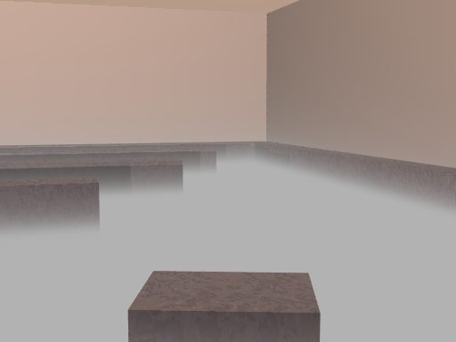

I feel really dumb now.
<rereads mega documentation> Mega creates extra intervals not
extra samples.
I had an odd idea that only one sample was needed and more would be created
as necessary.
Thanks for the help Peter. Pic looks a lot better now.
Gail

0.5a
Works fine now that I put the samples to 10.
Gail
