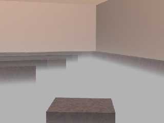

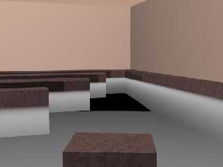

I was trying to get a fog-like effect with media, unfortunatly
I got the following picture. I thought initially that there was a non-hollow
object interfearing with the media, fog type 2 (ground fog) works fine.
The media container is definatly hollow.
The second picture is the same scene using fog type 2. That is what I want
to get with media
I've been fighting with this for two weeks now and I'm out of
ideas. I've posted the source for the simplified scene in p.b.s-f
If anyone can tell me what the problem is, I will be very grateful.
(Bill I have a feeling I'll need one of your signs)
Thanks
Gail

From: Gail Shaw
Subject: Re: Strange media effect. (20kbu)
Date: 4 Aug 2000 03:16:23
Message: <398a6dc7@news.povray.org>
Peter Popov wrote in message <961josgklq8m3mv5ahg1qqaut1aqubdno1@4ax.com>...
>On Thu, 3 Aug 2000 09:57:33 +0200, "Gail Shaw" <gsh### [at] monotixcoza>
>Looks like there're too few samples. Try starting with 5 or 10 and
>then use anti-aliasing along the way.
I feel really dumb now.
<rereads mega documentation> Mega creates extra intervals not
extra samples.
I had an odd idea that only one sample was needed and more would be created
as necessary.
Thanks for the help Peter. Pic looks a lot better now.
Gail

From: Gail Shaw
Date: 4 Aug 2000 06:03:15
Message: <398a94e3@news.povray.org>
Jerome M. Berger wrote in message <398A9182.66C040B7@iname.com>...
>Gail Shaw wrote:
> What version of MegaPov where you using?
0.5a
Works fine now that I put the samples to 10.
Gail
