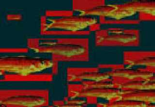

Sorry, this image should help.  In this image I made the background color
red.  Also, there is a blue/green fog.  the transparent sections of the .png
seem to ignore the fog, although where they overlap they show the correct
color of the fog...?
I'm using MP 0.5.  With .gif support gone I'm at a loss at what to do...
Making the background color the same as the fog is only a temporary fix and
still leaves a similar result as below when the map is in front of objects
other then the fog.
-Chris-

I'm guessing you are using infinitely-thin boxes or polygons to make the
fish? If so, POV may think it is "inside" one after hitting it, and
"outside" after hitting another, so the fog is only calculated if an
even number of fish are hit. Try making the fish hollow(so fog is also
calculated "inside" the fish), this might prevent it. Also, make sure
you have a max_trace_level large enough to get past all the fish.

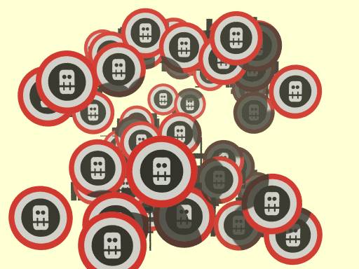

Try putting max_trace_level 50 (or higher) in the global_settings{} block of
your scene.

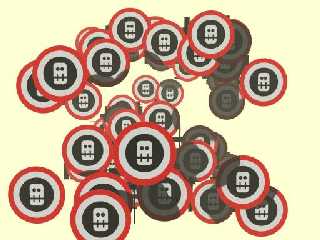

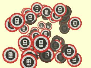

Attached are some pics which may help.  The first shows a scene without any
max_trace_level, the second with it set at fifty.  Spot the differenence.
The last two show the png image used, and it's mask/alpha channel.
The image was mapped onto a box using the following code:
#local alpha_thing=box {-0.5 0.5
  texture {pigment {image_map {png "robo_head" map_type 0 once}
translate -0.5}}
  scale <1,1,0.0001>
The scene was rendered using MegaPOV0.5a, if that makes a difference.
Hope this helps,
Alan.

Thanks, but no go...  The problem you spotted is fixed by my max_trace_level
of 40, but the problem I'm having seems to be a different one...
