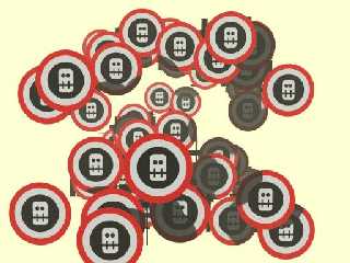

image map are showing the color specified in the background{} statement, as
shown in the image below, instead of the color behind it.  My goal is to
make a section of my image map simply 100% transparent other then by using a
.gif.  Is there something I'm doing wrong or is there some characteristic of
alpha channels that I'm not yet aware of?
-Chris-
Download 'scene_06aa.jpg' (8 KB)
Preview of image 'scene_06aa.jpg'

It's kind of hard to see. Which version of POV-Ray are you using? I rerendered a
few files and I think they were originally POV-Ray and I redid them with MegaPov
and got different results, but I haven't pursued the details.
Josh

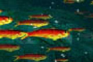

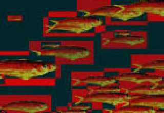

Sorry, this image should help.  In this image I made the background color
red.  Also, there is a blue/green fog.  the transparent sections of the .png
seem to ignore the fog, although where they overlap they show the correct
color of the fog...?
I'm using MP 0.5.  With .gif support gone I'm at a loss at what to do...
Making the background color the same as the fog is only a temporary fix and
still leaves a similar result as below when the map is in front of objects
other then the fog.
-Chris-
Download 'scene_06aa.jpg' (13 KB)

I'm guessing you are using infinitely-thin boxes or polygons to make the
fish? If so, POV may think it is "inside" one after hitting it, and
"outside" after hitting another, so the fog is only calculated if an
even number of fish are hit. Try making the fish hollow(so fog is also
calculated "inside" the fish), this might prevent it. Also, make sure
you have a max_trace_level large enough to get past all the fish.

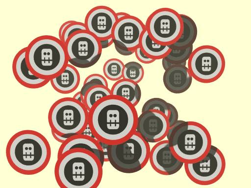

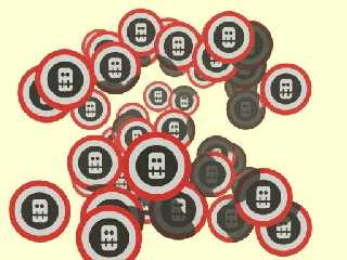

Try putting max_trace_level 50 (or higher) in the global_settings{} block of
your scene.
Attached are some pics which may help.  The first shows a scene without any
max_trace_level, the second with it set at fifty.  Spot the differenence.
The last two show the png image used, and it's mask/alpha channel.
The image was mapped onto a box using the following code:
#local alpha_thing=box {-0.5 0.5
  texture {pigment {image_map {png "robo_head" map_type 0 once}
translate -0.5}}
  scale <1,1,0.0001>
The scene was rendered using MegaPOV0.5a, if that makes a difference.
Hope this helps,
Alan.
Download 'alpha_no_mtr.jpg' (35 KB) Download 'alpha_mtr_50.jpg' (35 KB) Download 'robohead.jpg' (9 KB) Download 'robohead_mask.jpg' (3 KB)
