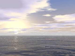

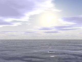

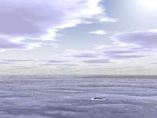

I'm sure someone has already tried this, but I haven't seen it yet, so
I'm bringing it here.
The cloud technique is fairly straight forward; a black hole warp is
used to displace shaded areas away from the light source. The pigment is
applied to a curved cloud plane and lit by ambient light. Although I was
using MegaPOV, the method does not depend on it.
The calculation sky colors based on sun elevation is sort of am
empirical hack. Not very straight forward, it still needs alot of work.
Anyway, the thing to look at is the lighting of the clouds in relation
to the sun.
Abe
P.S. The thing in the water on the lower right - don't ask me what it
is, I don't know. It just sort of showed up...thought it might be a
whale or something.
Download 'warp_shade1.jpg' (49 KB) Download 'warp_shade2.jpg' (48 KB) Download 'warp_shade3.jpg' (51 KB)

From: Mike
Subject: Re: Fast Clouds (non media)
Date: 1 Aug 2000 05:22:46
Message: <3986A416.3BA627D4@aol.com>
Those are probably the best single layer clouds I've seen.  Looks just like
the clouds in Bryce.
-Mike
From: Tony[B]
Date: 1 Aug 2000 08:48:39
Message: <3986c727@news.povray.org>
That is beautiful. I've been fighting with my media clouds to get something
like that. The problem is that with absorption, the light fades off at some
point, and it doesn't look right. If we could somehow give your clouds some
more depth, they would be perfect.

From: Paul Vanukoff
Date: 1 Aug 2000 09:29:35
Message: <3986d0bf@news.povray.org>
Perhaps utilize the layered planes (or spheres) trick. Of course, if you do
enough layers, you might as well use media at that point, due to speed
considerations.

From: Gail Shaw
Date: 1 Aug 2000 11:03:49
Message: <3986e6d5@news.povray.org>
Abe wrote in message <398### [at] taconicnet>...
>to the sun.
>Abe
Very nice. I like the first two the most. What pattern are you using for the
cloud layer? bozo?
Gail

From: Josh English
Date: 1 Aug 2000 11:38:34
Message: <3986EF88.6FB5AA8C@spiritone.com>
Beautiful. Share the source, please, because this is really really nice. What
is the render time?
Josh

From: Karl Pelzer
Date: 1 Aug 2000 13:04:36
Message: <39870389.A1D67918@t-online.de>
> to the sun.
Very interesting. I think the interaction of clouds (as a curved plane)
and sun is remarkable!
Karl

From: Abe
Date: 1 Aug 2000 16:48:53
Message: <398737AE.A2978AD6@taconic.net>
Displacement is probably the wrong term to use here. Consider it like
this: make a standard bozo texture cloud which has light edges and is
dark in the middle. However, to be more realistic, the edges should be
lighter on the side closer to the sun and darker on the farther side. I
tried to accomplish this by pushing the darker middle part away from the
light source.
Specifically, I used a inverse black hole warp centered on the sun to
offset the darker portions of the clouds.
Hope this helps.
Abe
