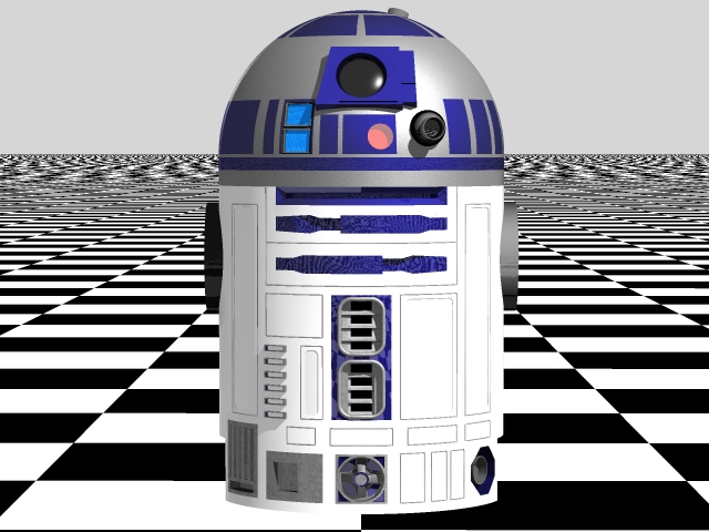

the front of the body is finished.  i need to do the sides, back,
bottom, and legs.  the head is mostly done.  the problem i was having
before was with multiple layers of pigment maps and their finishes.
finishes seem to add or multiply together and so the bottom layer was
outrageously bright.  what i ended up doing was making the head (a
sphere) hollow and putting a light and a camera inside.  then, using
megapov's spherical_camera and a 2:1 ratio, i made an image map of the
sphere.  after flipping along the axes, i used this image as a material
map, wrapping the original sphere (after taking the original
pigment-map-multi-layered-texture off).  next step is to use the same
image as a bump map since the blue areas are supposed to be slightly
recessed along the edges.  could someone refresh my memory; is black or
white the recessed color in a bump map?  that would mean the opposite
color sticks out right?  i'm still not satisfied with the blue or the
aluminum.  in the final version, i will be adding blurred reflection (a
la megapov) to both, and my tests show it helps a lot.  wish me luck.

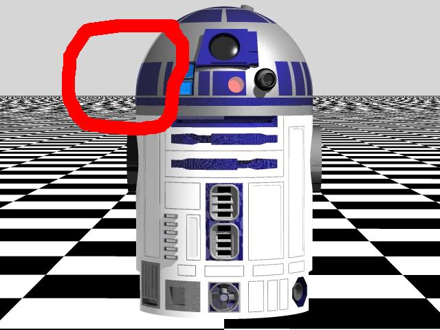

ryan constantine wrote:
I think you should fail kindergarden.  You're colouring past the
edges...:)

Nice!  Very good, I mean.
But...(Always a but)
I think your aluminium is too bright...
And too reflective (the blue parts on the body)
Doesn't really matter.  I mean: if you make a bump_map that doesn't look
right ('inside out'), just make the bump_size negative.
But I think black is down, white is up. (If you use use_color, that is)
And what about that blue part sticking out of the left of the head?  Media?
Motion_blur?  Variable reflection?
ZK

actually the blue part 'sticking out' isn't.  there is a fill light a
ways behind and to the left of the model and lights that edge just a
little.  that causes a sharper light to shadow transition.  i forgot it
was in the scene.  i had put the light in because i was moving the
camera around for test renders.
> edges...:)
i don't get it.  if you mean the left edge, check my other reply.  if
not, what do you mean?

Yes I did mean the left edge.  After reading your other reply, I retract
my statement.  Expect an official apology from my lawyers first thing in
the morning.
